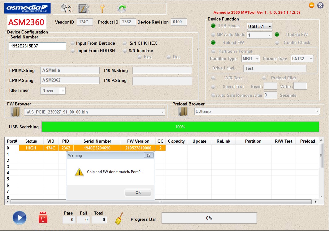

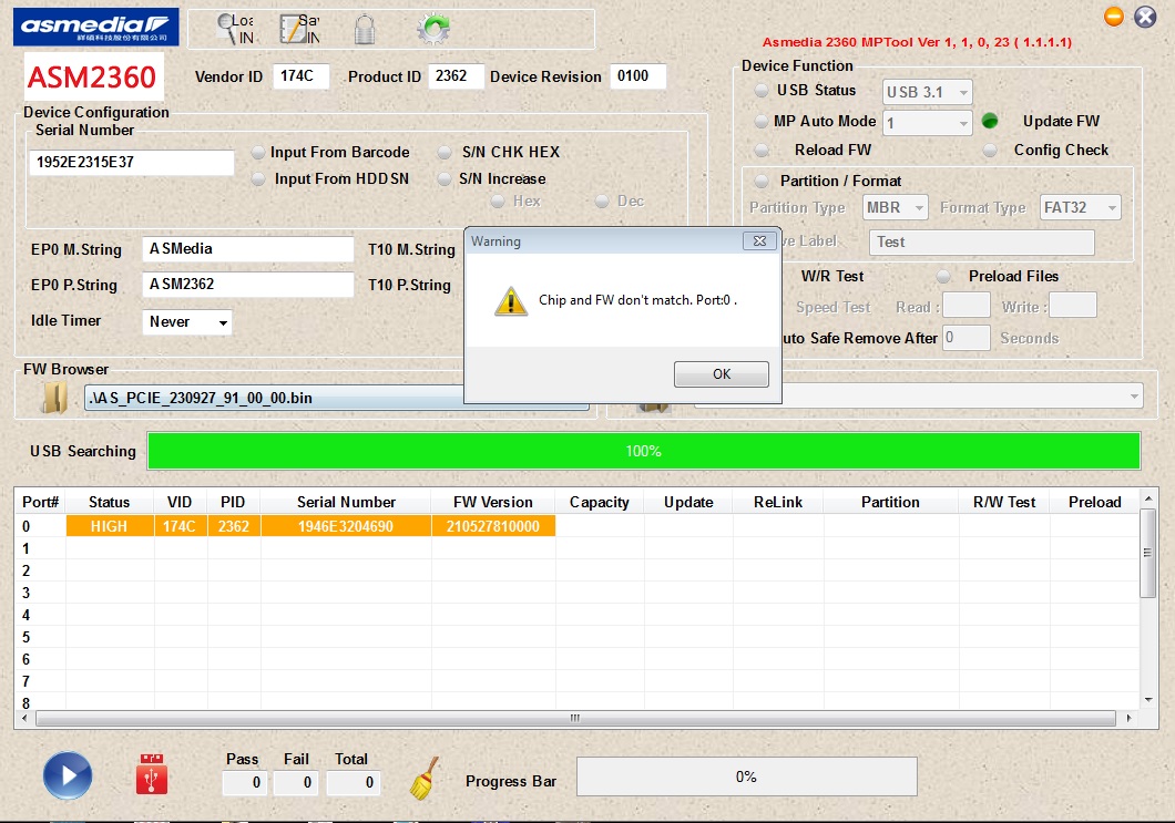

ASM2362 and ASM2364 firmware will most prob be cross flashable
the 10gbps lockout is usually done at the factory
I run ASM235CM firmware on ASM225CM just fine (locked at 5gbps though ofc)
as they are the same chip one is just locked at 5gbps one is 10gbps
also usbdev dot ru list
Asmedia ASMT-2360 Firmware (ASM2360, ASM2362, ASM2364)​
i would say there's a 99% chance it will work fine
if your feeling brave you can try flashing it
I posted them here
AS_PCIE_210901_91_00_00.bin
AS_PCIE_230927_91_00_00.bin
That was the first thing i did when i did get all firmwares from usbdev. I did try to crossflash but it is not accepted. ASM2362 and ASM2364 can't be crossflashed. I did try with older upgraders and also latest version and with all the result it is the same - FAIL

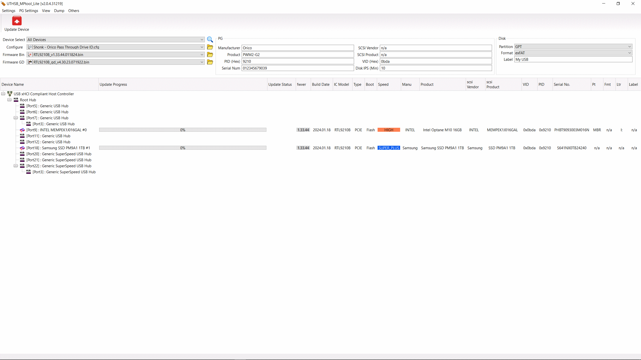

To be more exact there are 2 types of RTL9210 (10Gbps)
1. NVME ONLY MODEL RTL9210A witch has latest firmware available today 1.29.12 from 2022.01.11
2. NVME AND SATA MODEL RTL9210B with has today latest firmware available 1.33.44 from 2024.01.18
They cross flashable. I have updated successfully ASM2362 to AS_PCIE_230927_91_00_00.bin

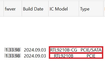

1. NVMe only model RTL9210B (in older flasher RTL9210_VB)
2. NVMe and SATA model RTL9210B-CG
And are also updated successfully to latest firmware 1.33.98

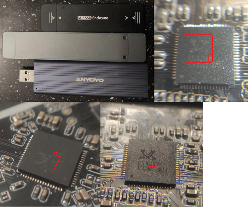

No mate, you are wrong again. As i said before , RTL9210A - NVME ONLY, RTL9210B- SATA+NVME. All of them come in different packageings hence the -something.
And to finish this once and for all below pictures of 2 of my enclosures NVME ONLY- RTL9210.

51
You have a very old model.

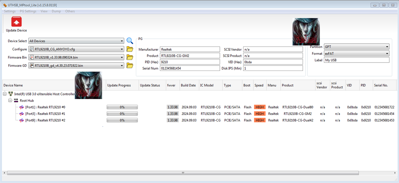

Shonky
Aug 14, 2020
15
9
I have 9 Orico PCIE only enclosures the chip's are marked RTL9210 on the chip not RTL9210A not RTL9210B
they are all running 1.33.98

As i told you before, variations of the chipset are A and B and in your case on B variation they did not enable sata for some models witch is normal.
I wanted to show you that i do have also older ones and not just B models and for those firmware stops at 1.29.12
B variant and it's variations are the only ones that got fw upgrades lately.
As i had at had 3 of my cases with B model , all are marked on chips with B letter at the end of the model as you can see in the next pictures and all of them are detected as B by the flasher.
Like this you can see the clear difference between A and B chips from RTL9210 and these 2 generations can't be crossflashed.

And to return at our previous discussion, NO, you can't crossflash ASM2364 firmware into ASM2362 because the downloader application will not let you, no matter the version.... and i did try all 3 of them available public. If someone did make this crossflash i am also curious what other means were used to do it.
For now this is the last public version for ASM2362, - 210527_81_00_00, but out there it is known to be another firmware, newer, 220906_81_45_00 should be the firmware customized by Micron for ASM2362

in that case its a lockout from flashing from xxxxxx_81_00_00 to xxxxxx_91_00_00 in the updater then
the actual firmware is fine try another flasher version older/newer
fantom3l
Mar 22, 2020
24
38
Nope, it is not working as i said before. tested with all 4 versions of flashers and with multiple versions of firmware including the custom ones 8D_XX_XX so none of the firmwares from ASM2362 do not accept the firmware from ASM2364
