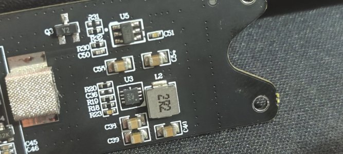

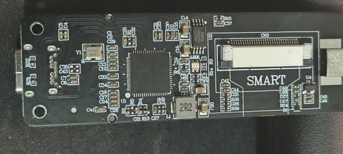

For ther display enclosure - i disected one today and found some simple ic with the name at U3 - 3124 4?J1 that does the job. I wonder what the complex ic's does.
This is a cheap DC-DC converter. Which can easily burn out if you install a disk with high power consumption.

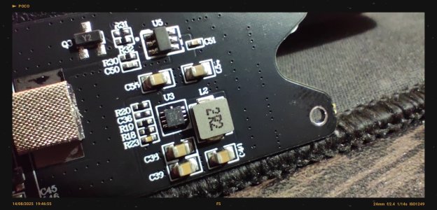

Thank you.. Then i wonder what the chipset is or a micro controller that helps get the data from RTL9210 to the display drivers.. Perplexity thought it was the IC at U3 that was doing the job of taking data and displaying on the screen which is a 128x64. I am curious what the chipset is and what code it has. Not sure if its out of scope for what we are dealing with here..
I cannot see any display related controller on the RTL side.
Of course 😎 Any case with OLED display SSD1306 directly communicates with RTL9210 via bus I2C. All the images you see on the screen are stored in the firmware. A separate controller is installed with customized displays. You asked where he is:

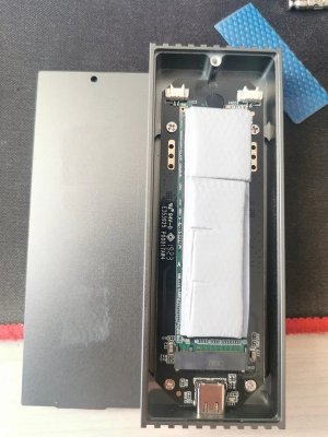

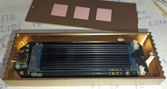

I have the same one ORICO on ASM2362. It has very thin and light aluminum. Lots of air inside. And it is necessary to select thermal pads according to height.
Honestly? ORICO and maybe UGREEN has a very high price for such products.
This is not mine but inside it is like this:
Found mine:
Found mine:
what model is your orico enclosure? I would like to get an asm2362 but it's hard to figure it out from the seller's websites. What's the autosleep?

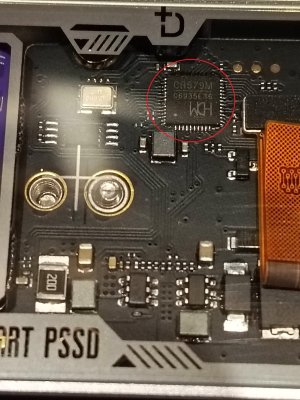

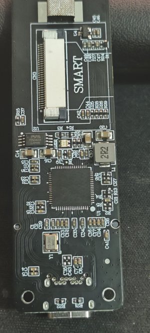

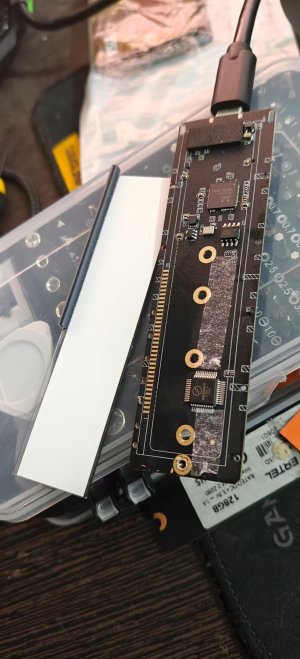

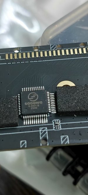

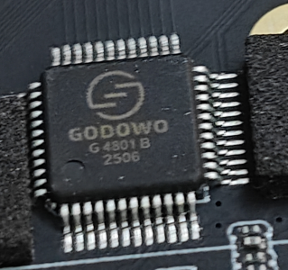

i disected one of this low cost display enclosure also and found few things that are extremely simple.. 1756020552986.png
Its got the controller side of circuit, the display side just has a LCD - zebra connector - a ic with the name GODOWO G4801 B. I cannot seem to find out if its a arm based STM or a lcd driver or both kind of inbuilt!
Its great to see how creative brands get to bring down the cost.
That is a ShuoLe enclosure and not such a low cost one. They do make all of them based on Realtek chipset and have also some good enclosures for old 2.5 drives based on rtl and with monitor screen.
