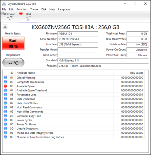

It turns out this isn't true. Reading SMART data is impossible in either Windows or Linux when using the XG6 with JMS583. However, h2testw finds no errors. Without the case, there are no problems. JMS583 firmware 2.1.4.
____________
smartctl:
=== START OF SMART DATA SECTION ===
SMART overall-health self-assessment test result: PASSED
SMART/Health Information (NVMe Log 0x02)
Critical Warning: 0x00
Temperature: -
Available Spare: 0%
Available Spare Threshold: 10%
Percentage Used: 1%
Data Units Read: 0
Data Units Written: 0
Host Read Commands: 0
Host Write Commands: 0
Controller Busy Time: 0
Power Cycles: 0
Power On Hours: 0
Unsafe Shutdowns: 0
Media and Data Integrity Errors: 0
Error Information Log Entries: 0
Warning Comp. Temperature Time: 0
Critical Comp. Temperature Time: 0
Error Information (NVMe Log 0x01, 16 of 256 entries)
No Errors Logged
____________
CrystalDiskInfo:
