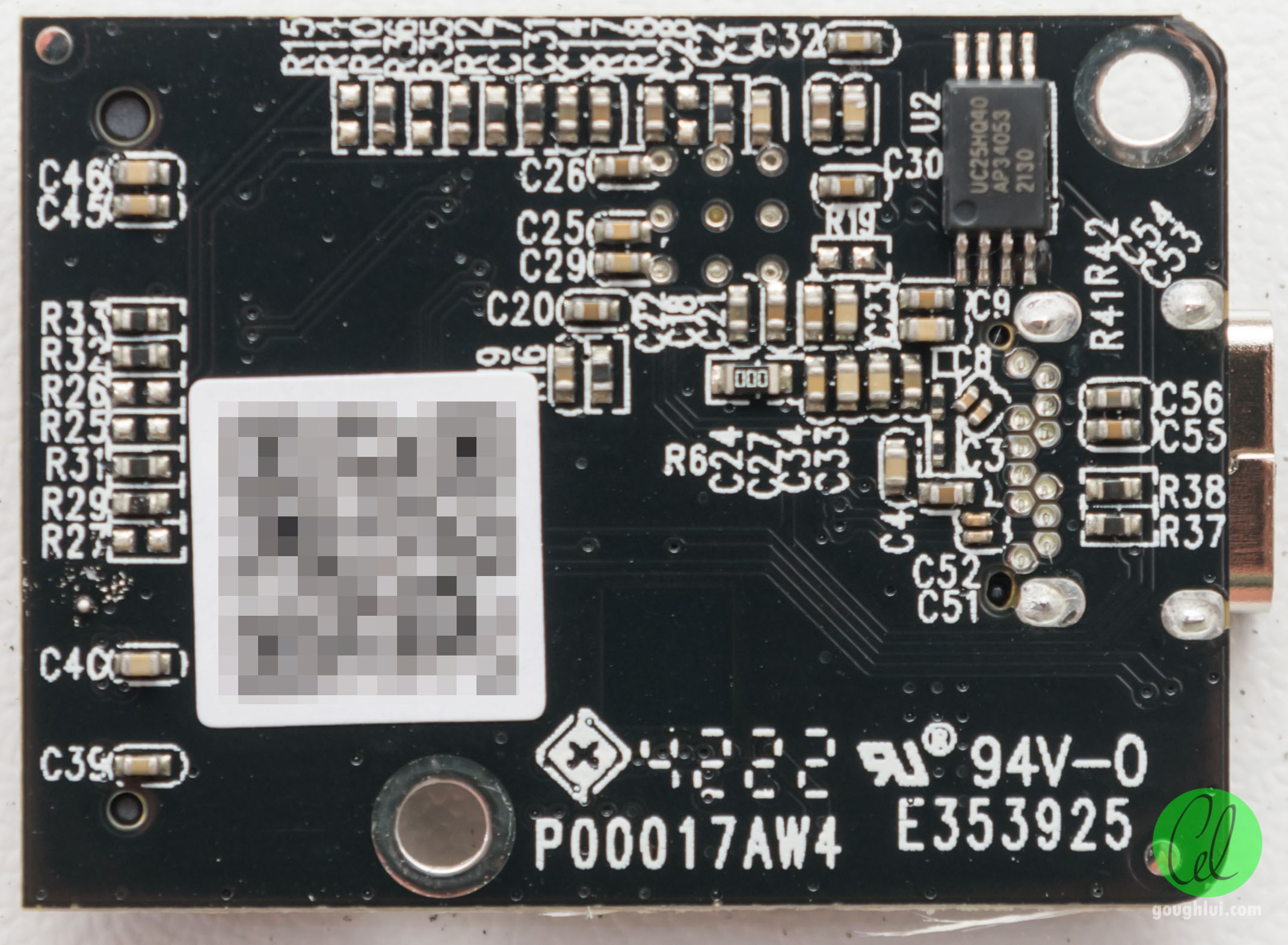

Hi, I bricked my Orico SSD NVMe PWM2-G2 enclosure with the RTL9210B.
I read that you can reset the flash memory connecting the 1 & 8 pin, but I do not which its the chip.
Someone can help with the pictures please?
Thx!
JPfx
Jan 10, 2024
41
Thx!
Good news!
I already save the device.
I did the bridge with a solder copper filament to the pin 1 & 8 of the UC25HQ40 and Windows 11 recognize the device after 2 seconds, then I cut the wire and proceed to the new flashing process.
I used UTHSB_MPtool_Lite v1.15.10.30417
The bin was RTL9210B_v1.32.68.062623_signed.bin
The gd RTL9210B_gd_v4.30.23.071922.bin
And the previous config file from the initial dump.
Thxs for your help!
Windows 11 still not recognize the disk inside the enclosure, that was the main reason for this proccess, I do know why...
If I use a live distro of linux I can use the disk with no problem.

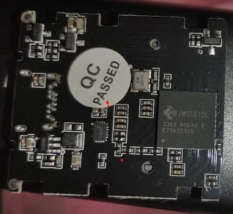

Ordered Ugreen cm559 in expectation to get Rtl9210b but got JMS583, hmmm
Ugreen firmware showed version 65.x, updated with 214 generic, need for going to generic was for uas protocol in openwrt as nas and it was detected as usb-storage protocol which is not fair, 214 worked wonderfully and instantly detected UAS
Want to know if 214 is latest? Secondly does this version has auto sleep as i don't want drive to sleep as using swap for 2gb as well, if it sleeps, is anything that can be done to not allow sleep for it?
@fantom3l
JMS583-STD-Release-v00.02.01.04-Bus Power.bin
