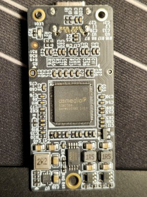

Have you tried using crystal disk info? I don't have your particular enclosure, but I have several oricos which use the rtl 9210b and crystal disk info is able to read the SMART data.
Yes, I have attached that picture too.
But the point is that it works.Who really cares about smart data.
I will try the Asus also with the asm2364 chip

I'm confused Victor! I thought you cared about getting smart data but you just couldn't read the data. I guess I didn't read your post carefully. Sorry.
I don't have an enclosure that uses any ASM chip, but I can say their PCIE USB 3.2 gen 2 adaptor chip works VERY well. Better than any other pcie USB port adapter card I have tried.
Anyway, please post again after you've tried the asm2364 chip. It's probably a good choice but I'd like to know more.

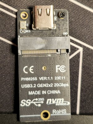

Hello.
Do you think this one will work well or is it scam?
It's supposed to be USB 3.2, 20Gbps, ASM2364. Just 24€
There are no reviews yet.
I have other alternatives.
Why do they state it supports a maximum 4TB disk size? They have just not tested anything larger or it really won't support it?
I've ordered one of those. Will report here when it arrives. The occasional disconnection of my current rtl 9210b enclosure, although rare, means I can't reliably use it. So, I'll test and see how this ASM2364 (of a higher speed class which is overkill but anyway) chipset will perform in comparison.

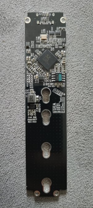

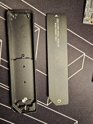

Hello, I would like to thank all the participants in this thread, it has been very interesting for me to know that there are JMicron JMS583, Asmedia ASM2362 and Realtek RTL9210 drivers.
I have asked the seller of this NVME case what controller it uses because in the advertisement I have not seen either in text or in the photos what controller it uses.
And this is Realtek RTL9210B..
And I think this is also Realtek RTL9210 because of the diamond shape of the chipset..
2023-11-12 02_33_39-Adaptador de carcasa SSD M.2 NVMe, caja de aluminio libre, USB C 3,1 Gen 2...png

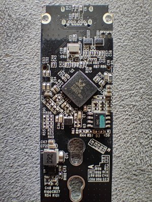

Where did you get that information from?

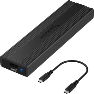

I have disassembled my Sabrent NVMe-USB enclosure unit and it has the Realtek RTL9210B driver but how can I see that information from Windows?
Jimminy
May 19, 2020
503
188
The tool which is used to flash the firmware also has a "dump/show device info" function. It won't dump the actual firmware, but does dump the configuration settings.

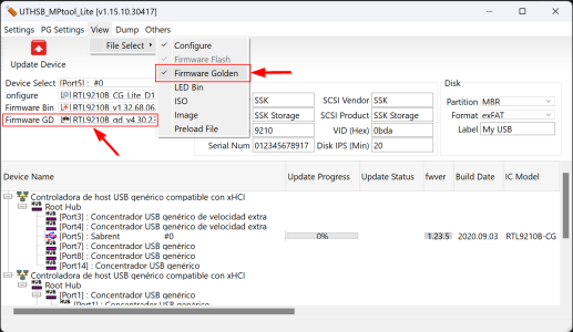

Great, thank you very much for such valuable information.
There seems to be a new firmware version 1.32.68.062623 from 31 Oct 2023.
My Sabrent adapter has the 1.23.5 version :eek:
What is the Golden firmware for?
Jimminy
May 19, 2020
503
188
I don't know much about that golden stuff, so I just left it set as it came in the flashing software. I didn't see anyway to change anything and also noticed that some of the firmware packages had the same golden version numbers.
I wonder if it's just a core portion of the firmware that doesn't change often. Maybe some of the guys here know more about it.
Reactions: MAL0W
