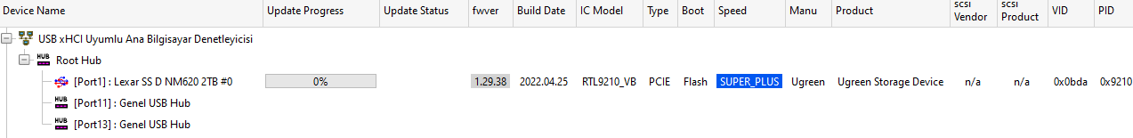

kaktus1907
Mar 12, 2010
12
I just grabbed a UGREEN 10Gbps NVMe enclosure (SKU 15512) for my 2TB Lexar NM620 Gen 3x4 NVMe drive. It has RTL 9210 controller on board. It comes with both USBC-USBC and USBC-USBA cables.
The case gets warm enough during long write session, but there's no thermal throttle. With this revision seems like UGREEN fixed the heating problem by using a thicker thermal pad than previous light blue cased enclosure (SKU 90541). Here're some quick benchmarks.
r/UsbCHardware - UGREEN 10Gbps NVMe Enclosure Benchmarks
USB-C, USB 3.2 Gen2 on Motherboard back I/O
USB-A, USB 3.2 Gen2 on Motherboard back I/O
USB-C, USB 3.1 Gen2 on Case Front I/O
USB-A, USB 3.0 on Case Front I/O
284GB Data Transfer on 3.2 Gen2 USB-C port, 2%
284GB Data Transfer on 3.2 Gen2 USB-C port, 50%
284GB Data Transfer on 3.2 Gen2 USB-C port, 95%
Edit: UTHSB MPtool lite shows IC is RTL9210_VB, firmware 1.29.38.

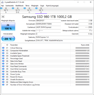

Have you tried using crystal disk info? I don't have your particular enclosure, but I have several oricos which use the rtl 9210b and crystal disk info is able to read the SMART data.
