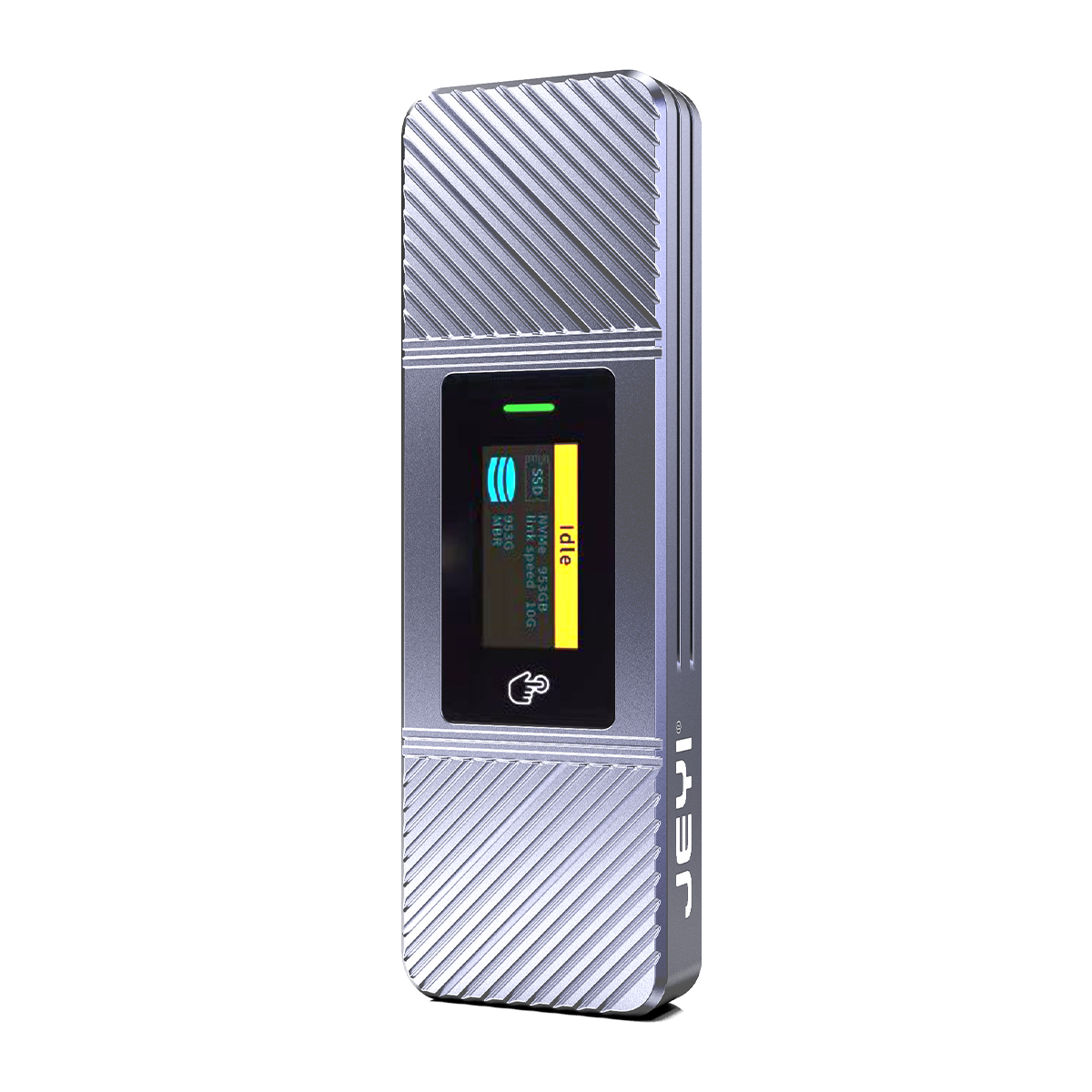

Has anyone tried the JEYI i9X-Zebra. It has an OLED screen and reads SMART data.
RTL9210b
Reactions: Trader05
