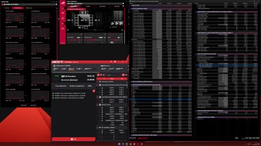

Quick testing in OCCT @ 600w with a ASUS 5090 Astral
AMP spread over the pins work as it should 🧐
GPU 12volt drops to ~11.8v average
Glad i went with ASUS time time around which is the sole vendor that have taken these problems with the connector serious
(only card with software monitor for amp draw over the pins)
PSU is a dark power 1000w
Have also bought the later released 12v-2x6 / 12vhpwr 90° cable pci-e for this psu

Having to run an additional piece of software to make sure that your GPU works correctly isn't a step in the right direction.

and how much did you pay extra for this projection AIB model which should have come standard on the $2000 FE?
I bought both my 5090's at stock (spesial) launch msrp. (got the TUF for 2k $ + norwegian tax)
Fully agree with everyone that is very slimy to raise the prices right after the first batch of cards got sold..
I'm just happy i manged to get both my orders in, without using any bots or paying scalpers
