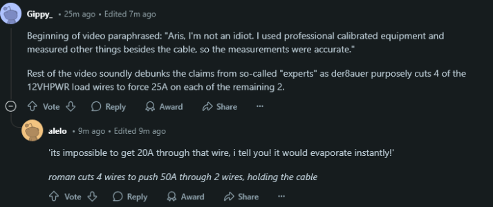

The cope on the r/Nvidia derbauer video post is hilarious.
The way he pushes the new cable in almost gently by jiggling his wrist shows alot of IQ there... You plug things like a switch, all in instantely you don't jiggle your wrist so the connector can make its way to the GPU that's completely stupid and wear the connector out even more and even faster making the pins inside moving and losing their optimal contact. I'm shocked nobody noticed this. He is too lazy to take out his gpu from his bench so he is already fucking the pins up on a brand new connector despite the already lame and awful Nvidia design.
