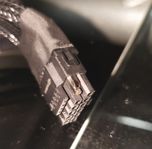

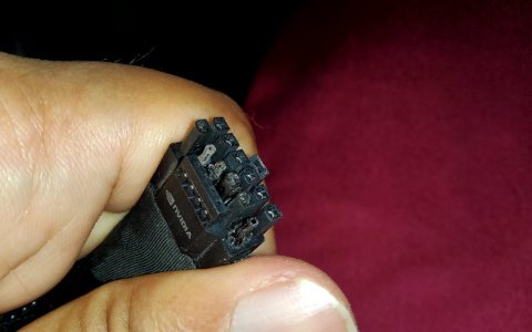

So, after some stories that surfaced online about the melting issues of the 12VHPWR power cables for the RTX 5090 and the RTX 4090, I’ve decided to check the one we’ve been using these two years for the RTX 4090.
Before continuing, I want to make it crystal clear that we’ve been using the official power cable for the RTX 4090 for over two years. We haven’t removed it when testing different GPUs. For instance, for benchmarking the RTX 3080, we’ve been using its own power cable. Same applies to the RTX 5080 and the RTX 5090. Moreover, the power cable is still working, and we haven’t encountered any stability issues.

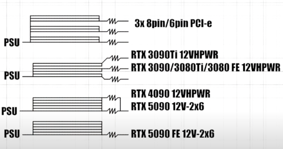

Andreas Schilling from hardwareluxx.de talked about 5000 series cards with AIBs.
Twitter post:
I did talk to some AIBs and they are well aware of the 12V-2x6 problems and wanted to get ahead of it. Colored plugs und LEDs can only mask the symptom. However, there was no second 12V-2x6 on the reference PCB and additional monitoring and protection circuits probably also fell victim to the design templates and time pressure.
Article, selectively quoted below:
The board partners have identified the problems, as the solution from ASUS shows. In some models, MSI also divides the six pins of the 12V-2x6 into two rails on their input, provides them with a shunt resistance, but then leads them together.
