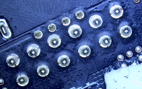

A few days later, he's had another four 4090s with melted connectors. One arrived at the end of this video and it had melted with a fully-seated 90 degree adapter.
This isn't user error. This is a defective product.
And what is extra worrying that most 4090's should still be under warranty, so logically, this is the tip of the iceberg. Only people who did a water cooling mod or something else to void their warranty should commission a repair themselves. The rest should be RMA'd.
But what happens when these cards run out of warranty and the same issues keep happening? Then you have to pay quite a bit of money to get a repair done, even though this is a defective product that should be recalled.

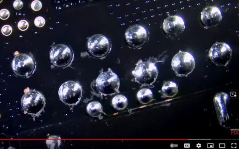

He worked on the card with the 90 degree Cablemod adapter. Despite firmly plugged into the GPU side, melting fused the adapter to the GPU.
But there was no damage to the adapter -> cable connection. This proves the problem is the connector on the GPU side, plain and simple.
And yet another burnt 4090 showed up while he was working. "User error", gg.

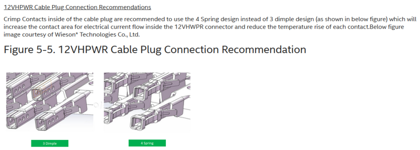

Oof, the fact that the 90 degree Cablemod connector was used and yet the card's built-in connector appears to be at fault really does suggest an inherent problem with (at least some of) the 12VHPWR connector designs. Might be why Intel recommended the 4 spring design over the 3 dimple?
As a side note his solder looks really clean.
