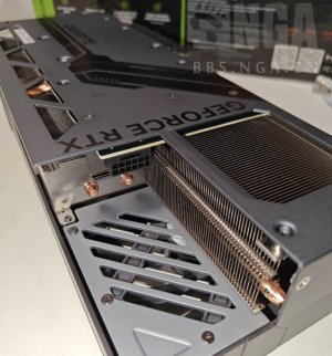

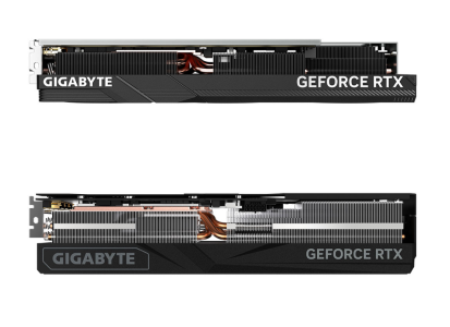

this might be the wrong thread and I don't know if i can link to tom's but they ran an article on a new version of the windforce 4090 with the 12vhpwr moved to the rear of the card. it'll be interesting to see if others follow suit later or in the future with other nvidia cards if nvidia doesn't drop this connector. it should reduce stress on the connector since there is no side panel bumping up against it but does pose another problem with shorter cases where there is not enough room for the cable or there is room but there's a thick radiator involved in the front business of the case

Colored plugs and moving the plug to the end are good things, but the fundamental problem is the same power from 3-4 PCIe going through a single 12VHPWR.
That and PCIe are solidly chunky and click into place with no movement in a very obvious way. This new one is smaller and can wiggle out with even minor force.

Look at this beautiful waste of cooling space. All this started as a way to save PCB space and allow for more efficient designs.
$2000 video cards are now the training ground for company execs playing as engineers.

It's not actually that bad. It would be better if they used a reversed connector with the latch to the back of the card, and then they could have a reduced depth heatsink all the way to the top of the card. Coming out the back like that will be really nice for cable management though.
-"How will consumers know that this is a high end card if it doesn't have 3 fans?" Someone in the C-Suite.
