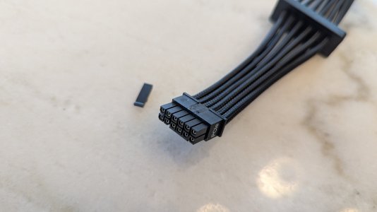

Took the cable off my Waterforce 4090. Put the cable on it nearly two years ago. Had to wrestle it off since it was on there so tight. Ended up breaking the clip. As much as the doomsayers wish it... no melty melty. 4090 also fine.
Now to sell the 4090.
