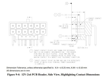

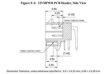

If you see something else that was significantly changed in the update, point it out, because this really appears to be about the sense pins.
One minor observation here would be that they appear to have changed dimension tolerance for elements in the PCB header side view. (essentially everything related to power pins and sense pins)

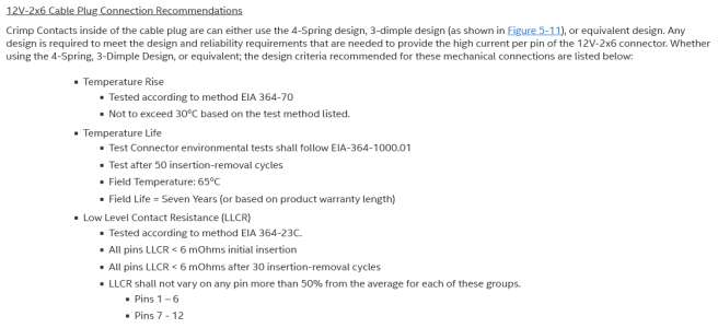

Last bit I remembered to check is related to the quality of the cable plug connection. At some points during the 12HPWR connector's life there appeared a recommendation on Intel's ATX 3 documentation to use 4 spring connections over the 3 dimple version. With the update to ATX 3.1 the specification for 12V-2x6 revert this recommendation and allow multiple connection types but introduce clear specifications for the quality of the connection:
View attachment 115930View attachment 115931

While there is more detail, It's still really about the sense pins. Remove the sense pin related changes and there really isn't anything substantially different.
First time around they missed the opportunity to use sense pins as a safety feature.
It's clear they just assumed (bad assumption) that connectors would always be plugged in correctly, and then the sense pins would be used to determine how much power the connector was configured to supply. That's all they were for.
Back then: Sense pins were so long you could be losing contact with power and still have a sense pin connection, and even with no sense pins it could still draw some power.
Now: No sense pins detected, no power. Plus they have shortened the pins and tightened the tolerances so they break connection early.
I expect this change will slash the issue by an order of magnitude, to the point where melted connectors happen less than they do for 8-pins (where it does also happen).

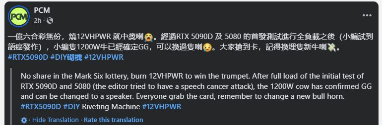

Thanks for the translation, much clearer.
Interesting that their cable seems to have melted at both ends.
I wonder if DeepSeek did that translation. :cool:
Note on VC page:
Update: PCM updated their post with new information. They now confirm they saw burn marks on RTX 4090, so presumably, the issue was spotted after testing 4090. It looks like user error after all.

Post is now flagged as misinformation, because same user bragged about running at max OC forever:
I did some digging on the poster's history and came across some rather interesting mentions of overclocking, they admit to pulling a mind boggling 925W through the air cooled card, hitting insane temps of over 160 °C.
Poster has deleted most of his top OC threads, since this was pointed out but you can still see the threads:
One poster even tells him, he's going to blow his 12v power connector and he says it won't. ;), and also says: "I paid for 100% of the voltage limit, im gonna use 100% of the voltage limit. Haha"
Basically all sliders to max...
