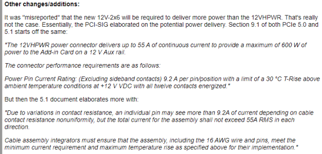

Informative articles on the topic:
Even with the new connector, the cable maker needs to strictly follow the PCI-SIG guidelines:
Seems it would be best to go with a reputable ATX 3.1 PSU and only use the included cable (or buy any additional ones from the PSU maker) and avoid 3rd party cables.
