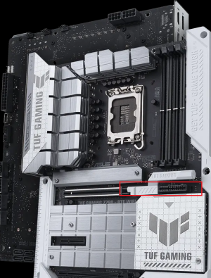

The newer 12V-2x6 fudges capacity a bit by mandating that cards that use it allow up to 75W through the PCIe connector on the motherboard, effectively increasing its rating and capacity by 75W.
They should increase the PCIe slot's power delivery to 150W minimum or introduce an additional dedicated power connector right next to the PCIe slot to provide power. It's stupid to have a huge cable going to the GPU when power could be routed through a cable connected to the back of the mobo's PCB or next to the ATX connector where the cable wouldn't interfere with much of anything else.

I would rather have a melted cable than melted PCB traces on the motherboard.
150W might not sound to be much, but at 12V it's 12.5A.

150W would certainly broaden the market for slot powered cards, but I can't see that taking off until the whole ATX spec gets overhauled. It's hard to imagine that without breaking compatibility, and since we already have a solution to add 75W to a card that's a lot of effort for a solved problem.

Not sure what that would even benefit. When the concern is high GPU power usage, adding 75W to the slot seems to be deck chair rearrangement.
The extra head-room would indeed be just a band-aid for the bigger problem: power budgets in the modern PC are out of control, doubly so on the GPU side.
150W on the PCIe slot would just enable the 650W GPU sooner rather than later.

The amount of people who have a motherboard with that proprietary connector on it, a GPU that uses it, and a GPU that draws large amounts of power is probably too small to draw any conclusions on its safety tbh!
Also, IIRC, those MBs with the special GPU connector, have a 12v2x6 pin connector on the back. That isn't removing the cabling. It's just hiding it, and adding yet another connector on the front. So this can only make any issues worse, not better.
Ugh no. The last thing you want to do is push more power through the motherboard. It is much easier to bypass the PCIe connector entirely and feed power directly from the PSU to the dGPU, which is why PCIe 6 and 8-pin connectors were created in the first place (and why 12VHPWR and 12V-2x6 were created to replace them). AMD learned this lesson the hard way:
Plus there are other reasons not to push power over the PCIe slot that are not germane to this discussion. Regardless it's a bad idea.
NV (or PCI-SIG, or both) have forgotten AMD's snafu by agreeing to a new cable spec that somehow encourages the video card to pull more power from the PCIe slot when the cable gets close to 600W. I guess they're hoping transient spikes will load the PCIe slot instead of the cable?
