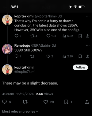

33% more cores and 33% wider bus on the same process and clocks probably won't regress. Maybe they won't reach 600W, but it'd be pretty surprising if there wasn't a bump in TDP.
That brings some interesting questions for "OC" partner cards. Everyone's done with one 12VHPWR connector so far other than that one Galax HOF with two, but if the default TDP creeps up near 600W we might see more of them with two. Actually finding PSUs for that will be fun though, most people would probably be looking at one native and one adapter?

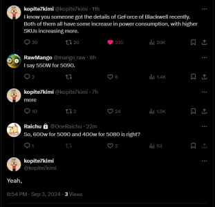

5090 TDP raised to 600W.
Who wants to bet that some OEMs will ship 450W cables in some of their boxes? Or even some 600W cables will get burned when using Furmark on these GPUs? Can Nvidia manage to release the most expensive consumer GPU with zero drama?
Haven't the 600W "rumours" been around for months?

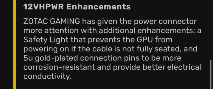

Don't they? Not the light, but isn't the main feature of the revised design a change in pin lengths so it won't start the card unless the connector is properly seated?
And even first gen cards had a light indicator and a protection mechanic that did not power the card under certain circumstances (probably coupled with the sensing mechanic). The "feature" was poorly documented though, and if we search for something like 3090 red light we get plenty of results from forums, some folks didn't even realize they were supposed to change their adapters with better cables.
