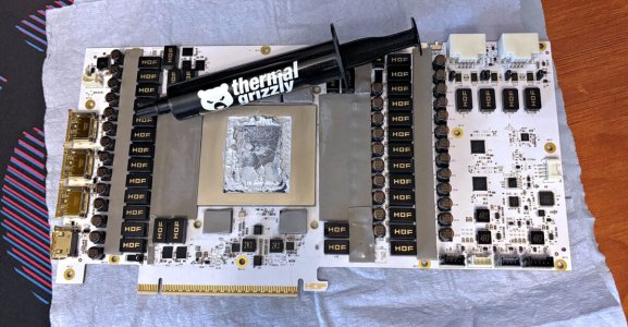

Galax has a 5090 with dual 12 pin connectors in their lab, it's not clear if they will, or are allowed to ship to customers, but they should. It also appears to have 5 shunt resistors for measuring incoming power:
Why would they not be allowed to ship to customers?
All partner cards have to get Nvidia approval. The thing that happened is likely that
1) visuals design guys want 1 connector/cable to look slick and they got the upper bosses on board with that idea (against the engineers, possibly).
2) inevitable safety issues
3) you (Founders edition cards) don't want to look bad/usafe next to partner cards that would put two connectors on their stuff to give better safety margins.
4) disallow partners from making 2xcable cards to "solve" problems 2-3.

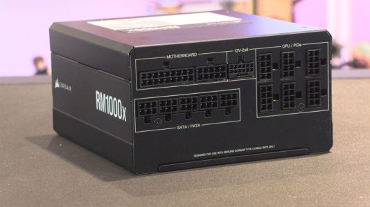

5) creates mayhem among PSU makers, as there most certainly are PSU models out there with a single 12V-2x6 connector that are more than capable of handling the 5090.
The entire marketing pitch for this connector was built around 1x connectivity for anything except extreme builds / overclocking.
Well, those can still throw the spider adapter from 8pins on a double-cable card. Which is what people started recommending for RTX 5090 anyway when the native cables started melting, ironical given how everyone first got new PSUs with native/straight 12+4 cables...

NV's reference design for the 4090Ti already uses two connectors, though. All they had to do was copy that. The only technical reason I've heard as to why they didn't do that is that some designer or another insisted on limited PCB space for a specific airflow/heatsink topology, leading to the single connector at an odd angle.
