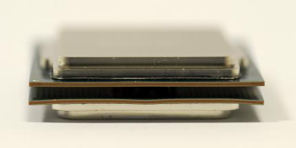

What they found in the shipping box after their "test" shipping. :D
Skylake on bottom is from same system after"test" shipment
PCB on left is Skylake compared to older ll5x PCB or right
http://www.pcgameshardware.de/Skylake-Codename-259478/Specials/Skylake-Gefaehrdung-durch-Kuehler-1180505/
So, yeah, you can definitely do a lot of damage. But it is equally definite that to do that kind of damage requires extreme effort. ;)
