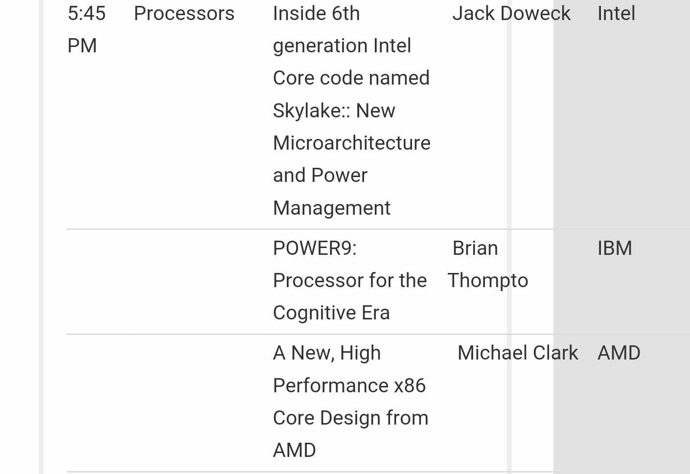

Yep. And <8-way SMT.
They'll present on this at Hot Chips before AMDs presentation.
FD-SOI seems to have noticeable benefits with planar UTB FETs (according to ARMs older presentation) https://scsong.wordpress.com/2009/10/14/soi-reduces-dynamic-power-wafer-costs-coming-down/
Sent from HTC 10
