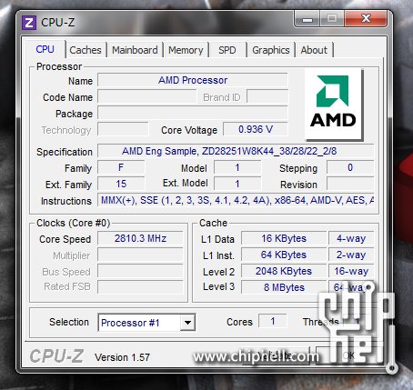

Fottemberg seem to be posting this image all over the place:
If his point is showing that even early prototypes of Bulldozer didn't hit very high frequencies, someone could tell him that's not the case.
Prototype Model 2820 - 3.6GHz - Rev. A1
Prototype Model 3120 - 4.1GHz - Rev. B0
Bulldozer Rev. B2G ended up shipping at 4.3GHz (FX-4170).
Rev. A1 was the first revision which was complete in terms of features.
The part in the CPU-Z screenshot is Rev. B0 (44 ending).
As far as I know, at silicon level Zeppelin has been already finalized. Because of that I find those rumors about "samples operating at just 2.4GHz" pretty unlikely.

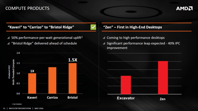

At Computex, and seemingly in a recent investor slide, they've been comparing Zen to what it is replacing which is FX Vishera. Imo, so they can make less nuanced ("Up to", "common workloads") IPC claims like their unambiguous "40% more IPC" Computex slide.
Comparison with the FX is for this slide, so SKU vs SKU :
And comparison with XV, so core vs core :

Page 13 of the current version of the investor presentation slide says "Over 40% improvement in IPC over current AMD CPU core", just like rest of the slides do (core). Current generation cannot mean anything but 15h family, and all 15h family designs are compute unit based. Since there are 1-4 CUs in the designs which AMD call as 2 - 8 core products, there is exactly zero room left upon interpretation.

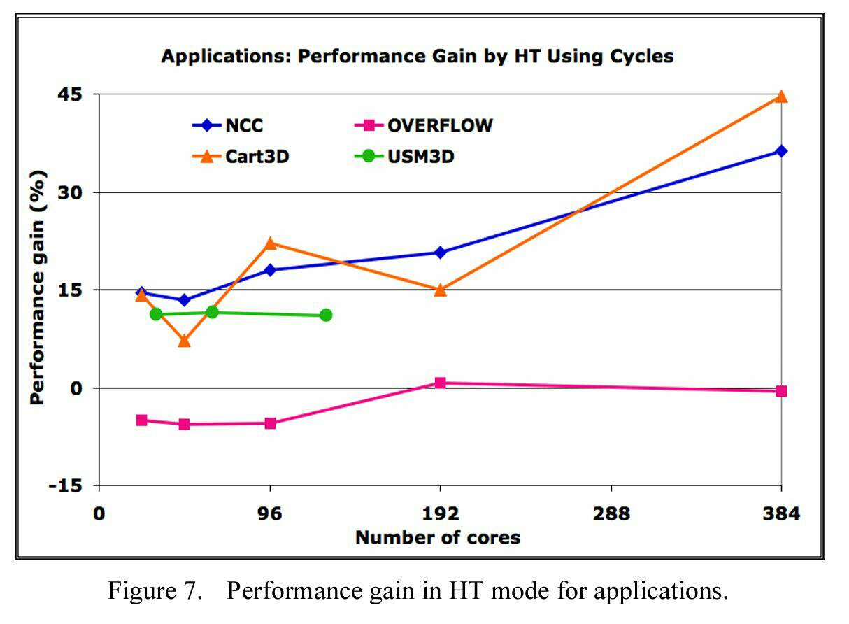

A penalty occurs with some code depending on their instruction mix, but that big only with code like loops avoiding tiered cache/mem designed for absolute throughput measurements.
Edit: Westmere-EP was studied with professional FP workloads: https://www.nas.nasa.gov/assets/pdf/papers/saini_s_impact_hyper_threading_2011.pdf
SMT gain was approx. -7% to 15% for 24 cores, more with higher core counts. The negative results correlated strongly to the amount of vectorization in the code.
Lol, so Piledriver is the "current" AMD core, including APUs..
Current AMD core means the current design, not their 2012 design...
In case you missed the post :

It is said Excavator in the slide that mention Zen and said 40%, notice that the comparison is explicitely Zen, wich is a core :
On the other slide it is mentionned Summit Ridge, and that s in comparison to the Vishera based FX :
So the first slide is for IPC in comparison to XV while the second one compare whole CPUs throughput wise.
It s logical that FX is used as basis for plateform comparison since it s the higher throughput SKU in AMD s current line up, and we re talking of high perfs DT parts after all...
