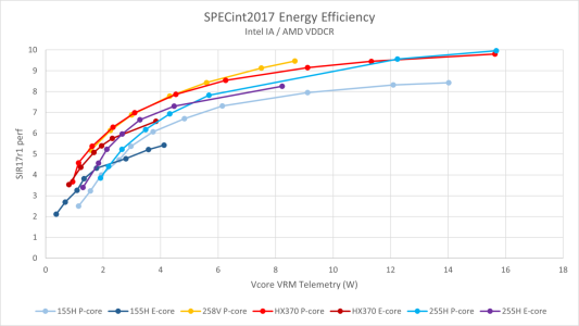

47% higher peak performance as well ... ability to scale to multiple design be it laptop or desktop?
Why not just compare it to the X4, which is ~10% bigger without the L2 sram cells, meaning without the other extra L2 logic it should be similar in size if not outright smaller?
Also, a 4c X4 cluster is smaller than a 4c Skymont cluster, only counting up to the L2.
An iso area comparison makes much more sense.
Okay, but you implied that the e-cores aren't competitive with ARM cores in PPA. I don't see any evidence for that.
Look at the X4 in the mediatek 9400 and you would see a very different picture. Similar peak perf, but both smaller and much better power.
If power consumption is the issue, we can account for that. David Huang's 255h review has a perf/watt graph. Skymont at 4W is still 15% faster than the A725 in GB10. 15% more performance for 30% more area at similar wattage is very competitive.

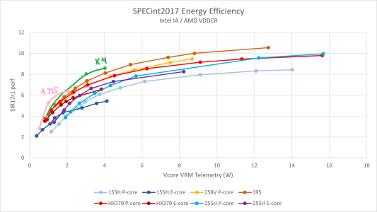

How exactly do you know how many watts a A725 uses in GB10?
The A725 in the Xring clocks 21% higher than the one in the GB10 and consumes ~2 watts from Geekerwan's specint testing. The GB10 A725 power consumption has to be tiny.
We can actually use that graph and relativize it to Geekerwan's SOC power (for mobile phone) power graphs to get some interesting results. Mind you, the projected Geekerwan numbers should be the worst case scenario for ARM here, since Intel is projecting just core+cache (actually for the E-cores the L2 cache isn't in the figure) while for Geekerwan the entire SOC is being measured, including the power hungry mem PHYs. As much as you can subtract them from idle, when they are fired up they still consume extra power....
I did this as a fun thought experiment a lil while ago for the 5/4nm class cores, but using that graph you gave:
As a reminder, this is the absolute worse case graph for ARM, due to the way geekerwan is testing the power.
Huh? From what I've seen, X4 is bigger than Skymont, not smaller.

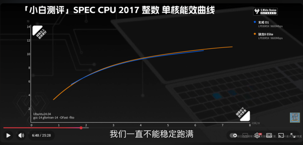

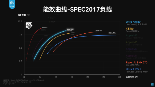

  1. You can't compare SPEC results done under different test conditions.
  2. Geekerwan's power consumption measurements for phone SOCs are highly questionable. If we were to compare the 8 Elite to the X Elite. The phone SOC appears to be over 3x more efficient at every point on the curve.
Either his numbers are wrong, or phones are somehow far more efficient than laptops. Either way his phone power consumption numbers are useless when comparing to laptop CPUs.
The X4 has a private L2 cache. Skymont does not.
You can compare it either as a 4x X4 cluster vs the Skymont 4c cluster, or a X4 core without L2 SRAM arrays vs a Skymont core, and you get it being smaller or similar in area.
I didn't. At least not directly. I used relative scaling based on Huang's results vs Geekerwan's results based on the Oryon V2-L core.
It's understandable once one considers how much lower the uncore power for a smartphone chipset has to be vs laptop chips.
Here's an example-
Say a smartphone has a uncore power of 1 watt, and a core scores 5 points at 1 watts of power. Now say a laptop chip has an uncore power of 3 watts, and uses the same core.
So the smartphone, from a SOC power perspective, takes 2 watts to score 5 points, however the laptop chip, due to the way higher uncore power, takes 4 watts to do so, esentially 2x the perf/watt.
That and the 8 elite is a node shrink vs X elite.
Well that's why I didn't use SOC power. I used the core power graph you provided, vs the SOC power for the mobile phones from Geekerwan. Meaning that the ARM cores are disadvantaged, while the x86 cores on the graph you provided are at a large advantage. This is especially true at lower power, where the uncore power takes up a larger percentage of total SOC power in comparison to core power.

I know it's measured differently. But the discrepancy is so huge that the higher consumption of the laptop chassis can't account for it.
It definitely can. Esp once you also consider Geekerwan's testing methodology- not software, but like Qcomm, it's idle normalized hardware readings. He applied this to laptops too, because Qcomm doesn't give power readings via the device itself or through software.
Besides, I'm not using Geekerwan's laptop testing at all, just his mobile numbers. Your main point of contention appears to be the how the mobile numbers are so low. Well, I assure you, you can find data from other reviewers as well confirming that yes, the SOC power actually can scale that low:
Moreover you can also see how the results are very similar to what Geekerwan has. The Xring O1 and Oryon V2 cores have very similar perf and perf/watt curves, like Geekerwan's data showed. Moreover, you can see a very similar ~3.7x ratio between the peak perf and the Vmin of Oryon V2.
Ofc the absolute numbers are different, but the important thing is that relatively everything between the two graphs are similar.
