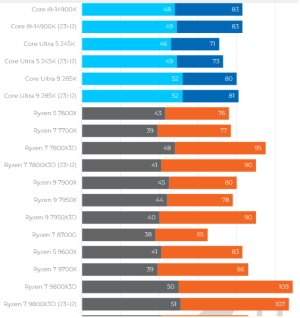

Does anyone here know if a Ryzen 7 9800X3D beats a Core Ultra 9 285K in X-Plane 12?
At this site they know, with Windows updates comparisons for both CPUs.

  • Screenshot 2025-02-01 at 00-05-53 Test du Ryzen 7 9800X3D le nouveau maître du jeu !.png
