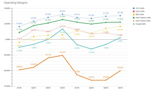

Seems like Intel still believes that they can fund this insanity forever when in fact, this will all come down to efficiency as you mentioned. It isn't just about who can make the fastest processor, it is about who can make the fastest processor and make money doing it!
They are suffering financially in a market with uptrend. If they do not reverse this quick, when the downtrend happens, they will be gone.
Reactions: Tlh97 and 511
511
Jul 12, 2024
5,395
4,817
Well I don't think so cause they have not benefited from AI as much other companies
