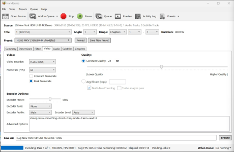

Here's the test file: https://4kmedia.org/lg-new-york-hdr-uhd-4k-demo/
1. Use the following version of Handbrake with the built-in h.265 mkv 2160p60 preset
HandBrake-1.3.3-x86_64-Win_GUI.exe
Don't forget to turn on logging in Handbrake so you can retrieve your time. Tools>Preferences>Advanced>Logging
Once this current version is replaced you'll be able to access this version from the following link.
HandBrake: Nightly Builds
Nightly builds of HandBrake
handbrake.fr
2. Report your encoding time, average CPU frequency, and Package Power. If you have a hybrid CPU you can turn off the E's in the BIOS. For E testing turn off all P's except one in the BIOS, clock it down to 800MHz, and then shut it down with Process Lasso. Or just report your score with 1 P at 800MHz and let me know you did that so I can subtract out that P core's (minor) contribution to the encode.
Here's how to report your average clock and package power so we are all doing it the same way.
Handbrake does some housekeeping right after you start encode and when the progress bar gets to 100%.
This could result in lower than actual average clock.
After you start the encode, wait a few seconds until you see the green Handbrake bar appear, then reset the HWinfo counter.
At the end don't wait to grab the screen shot at 100%, just do it sometime after about 95%.

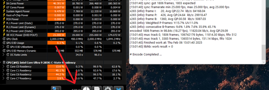

well ArrogantHair's 285K isnt stock (E-Cores are oced to 5.0 from 4.6) and isnt consumig 200w on average while running the encoding bench but while he has hwinfo open (which is for a longer time than the encoding task). Looking at peak, it is 285W, so I guess that encoding average power consumption for his 285K really is 265-275W. Far from efficient.
Good points. Perhaps ArrogantHair could jump in here. I had assumed the power jumped to 285W at the start, like a PL1 thing and then came down.
But if you are right then the average clocks I used are incorrect as well.
@ArrogantHair - Can you confirm that you reset the HWinfo counter right after the encoding started and stopped it right before the encode was finished? In order to make these results legit for analysis we need to make sure everyone is following the same protocol.

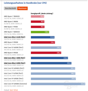

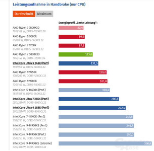

At Computerbase they use currently Handbrake to mesure power comsumption.
The 285K in this task, H265 converted to H264, is 6% faster than the 9950X but to do so it require 242W on average while the 9950X average is 177W.
285K hoover at 222 - 263W and the 9950X at 159 - 196W.

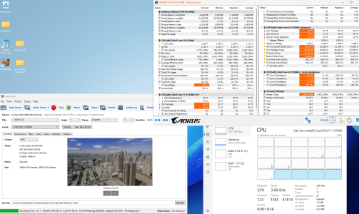

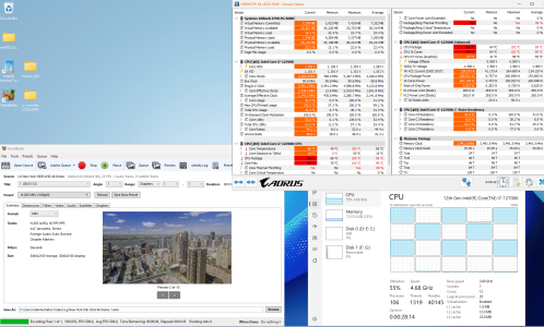

Funny thing. Encode completed fine on my 12700K with P52 E39 but during the E-core only run, the CPU fan doesn't ramp up so the E-cores heat up too much around 26% of the way and the system suffers a thermally triggered restart. Had to undo the overclock for the E-cores to chug along at 3.6 GHz. Four E-cores shouldering this encode is like reliving the good old days of Core i5 with no HT: painfully slow!
Reactions: lightmanek

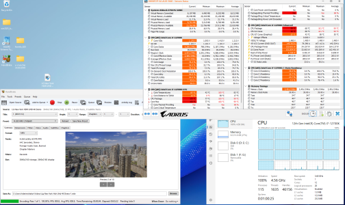

ArrogantHair
Feb 6, 2025
53
45
51
I stopped it before starting and snapped a pic when it finished. (I think it's correct, but when I share another run we can confirm)
The arrow lake boosts for short periods per core before remaining below a threshold, so wattage isn't a flat draw. Yeah, it consumes more power than the 9950X when benching, but consumes a LOT less while idle. So both CPUs are efficiency opposites.
I have to tune mine more, as I am not getting full performance out of my P-Cores. I don't think it's due to lacking a custom water setup - although that would help. I think I have something misconfigured. E-Cores are solid.

Free guessing, does it says 2min and 16sec here ?
136s - 99s runtime = system was ideling for 37s after the run and lowering the averages (?)

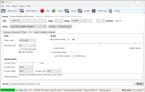

AVX512 did actually help out a tiny bit in handbrake1.33 for the 9950X ;)
Went from 22.75 FPS to 24.51 FPS when maxed out on PBO tune :cool:
  • 9950X @ optimus signature v3 waterblock
  • ROG CROSSHAIR X870E APEX
  • 2x16GB G.Skill Trident 8000 Z5 Royal Neo hynix a-die @ custom heatsinks + 2x noctua 60mm fans ontop
  • memory is running ~8509MT/s CL32 (8400 * 1.013 baseclock)
  • FCLK is running ~2228mhz (2200 * 1.013 baseclock)
  • hwinfo have snapshot pulling mode enabled, not sure how much it lowers performance having it open
16/32 AVX512 with PBO curve optimizer maxed out
HandBrake 1.3.3 (2020061300)
OS: Microsoft Windows NT 10.0.22631.0
CPU: AMD Ryzen 9 9950X 16-Core Processor
Ram: 32402 MB,
GPU Information:
Microsoft Basic Display Adapter - 10.0.22621.1
Screen: 3840x2160
Temp Dir: C:\Users\Administrator\AppData\Local\Temp\
Install Dir: H:\Clean install Windows 11\5950x\programmer\Handbreak\Handbreak 1.33\HandBrake
Data Dir: C:\Users\Administrator\AppData\Roaming\HandBrake
# Starting Encode ...
[11:59:42] base preset: H.265 MKV 2160p60 (Modified)
[11:59:42] hb_init: starting libhb thread
[11:59:42] Starting work at: Fri Feb 07 11:59:42 2025
[11:59:42] 1 job(s) to process

I did some testing and here is what I found.
Using Handbrake version 1.9 without AVX my encode is 4 seconds slower. With AVX512 enabled it is 5 seconds faster.
Using version 1.3.3 the encode is about 4 seconds faster with AVX512.
Are you sure you are using the same settings in 1.9 as 1.3.3 because there isn't a template that is the same?
I created a custom user template in 1.3.3 called "Handbrake Test" and then exported that. It won't let you export a preset, you must load it (select it) and then export.
Then I imported that template into version 1.9 and ran the tests to be sure I was using the exact same settings.
For an accuracy measurement, As @Hulk says, you need to reset the HWinfo counter right after the encoding started (a pair of seconds after it started, for example) and take a screenshot a second or so before it finishes

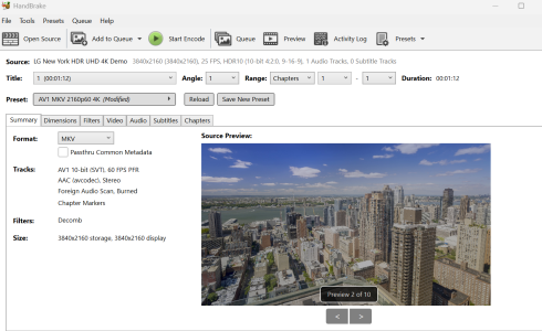

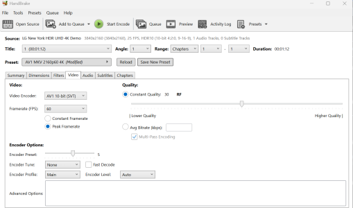

yes please, include AV1 encoding as well. The AV1-SVT software encoder makes use AVX-512 by default. I suggest these settings for AV1 encoding:
Is it a disadvange to make use of your CPU instructions? I don't think so. btw the 7700X is fast with AV1 encoding. Imagine the 9950X
EDIT added more details:
28,174
19,219
New thread then. And depending on the uplift from the use of these instructions that Intel is too snobbish about letting loose in their consumer line, it may become an AMD only thread :D
I'm showing the video settings in my screenhots with version 1.9
They are as close to 1:1 with version 1.33 as far as i could get them

I'd probably be more interested in AV1 than x256. Isn't AV1 supposed to be the future because people had issues with royalities regarding h265?
poke01
Mar 8, 2022
4,889
6,236

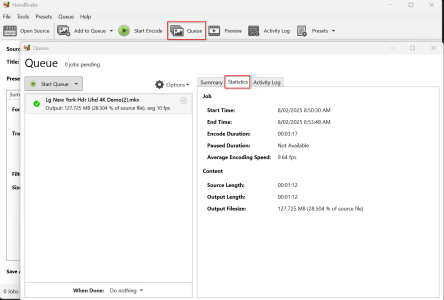

Just a tip when doing AV1 encoding. The logs won't show the time run or avg fps for AV1, so click on queue to gather this info.

Hope this did not go unnoticed: https://forums.anandtech.com/thread...te-overhaul-of-the-test.2588294/post-41390427
Wondering when I can see Golden Cove in the fps/core/GHz chart :)
This is great data but can you double check your average frequencies on these? They seem a little low based on min frequencies in your data.
After you start the encode, wait a few seconds until you actually see the green progress line so you know the encode is taking place, then reset the HWinfo counter. Near the end you can grab the screenshot at less than 100%, things are going to change much even from 95% to 100%. At the end the encode stop and Handbrake is just doing some housekeeping, which could also bring down the average clock.
You have a lot of data that is going to chance the "throughput" chart quite a bit so I want to make sure all of the data is spot on!
Thanks.
