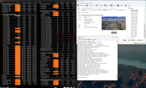

2. Report your encoding time, average CPU frequency, and Package Power. If you have a hybrid CPU you can turn off the E's in the BIOS. For E testing turn off all P's except one in the BIOS, clock it down to 800MHz, and then shut it down with Process Lasso. Or just report your score with 1 P at 800MHz and let me know you did that so I can subtract out that P core's (minor) contribution to the encode.
Here's how to report your average clock and package power so we are all doing it the same way.
Handbrake does some housekeeping right after you start encode and when the progress bar gets to 100%.
This could result in lower than actual average clock.
After you start the encode, wait a few seconds until you see the green Handbrake bar appear, then reset the HWinfo counter.
At the end don't wait to grab the screen shot at 100%, just do it sometime after about 95%.

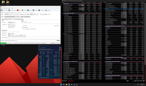

The 9800X3D throughput advantage of 14% in the chart might be real.
I did some calculations using TechPowerUp x265 encoding benches and they are showing a 9% advantage for the 9800X3d vs the 9700X. Yes, I took the clockspeed difference into account. I don't know the exact clocks they were at during their test so I used the max clocks TechPowerUp found during testing for my calculations.
Regardless, when the 9950X3D arrives I think we will have a new CPU at the top of the charts.

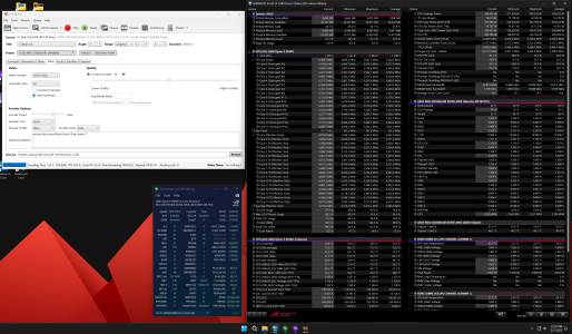

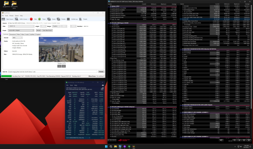

I kinda suspect GHZ/FPS will go up for my 9950X if i disable CCD1 and run it as a 8 core cpu
If it can match the 9800X3D i dunno, but it will be better to some degree atleast.
Each core will have higher available bandwidth then in dual CCD mode, and zero crosstalk penalty.
Also my runs were balls to the wall, way past the efficieny points of no return... If i lower PPT limit it will look much better in efficiency
So, i have disabled CCD1 on my 9950X to simulate a 9700X, for some 8 core / 16 thread action :)
  • 9950X @ optimus signature v3 waterblock
  • ROG CROSSHAIR X870E APEX
  • 2x16GB G.Skill Trident 8000 Z5 Royal Neo hynix a-die @ custom heatsinks + 2x noctua 60mm fans ontop
  • memory is running ~8509MT/s CL32 (8400 * 1.013 baseclock)
  • FCLK is running ~2228mhz (2200 * 1.013 baseclock)
  • hwinfo have snapshot pulling mode enabled, not sure how much it lowers performance having it open
8 core / 16 threads vanilla Zen5

[12:24:36] reader: done. 1 scr changes
[12:24:42] work: average encoding speed for job is 12.962785 fps
[12:24:42] comb detect: heavy 1091 | light 277 | uncombed 438 | total 1806
[12:24:42] decomb: deinterlaced 1091 | blended 277 | unfiltered 438 | total 1806
[12:24:42] vfr: 1806 frames output, 0 dropped and 0 duped for CFR/PFR
[12:24:42] vfr: lost time: 0 (0 frames)
[12:24:42] vfr: gained time: 0 (0 frames) (0 not accounted for)
[12:24:42] aac-decoder done: 3384 frames, 0 decoder errors
[12:24:42] hevc-decoder done: 1806 frames, 0 decoder errors
[12:24:42] sync: got 1806 frames, 1803 expected
[12:24:42] sync: framerate min 25.000 fps, max 25.000 fps, avg 25.000 fps
x265 [info]: frame I: 20, Avg QP:22.74 kb/s: 84168.04
x265 [info]: frame P: 426, Avg QP:24.64 kb/s: 29918.47
x265 [info]: frame B: 1360, Avg QP:30.58 kb/s: 5087.03
x265 [info]: Weighted P-Frames: Y:15.7% UV:11.0%
x265 [info]: consecutive B-frames: 9.6% 1.8% 7.6% 35.9% 45.1%
encoded 1806 frames in 140.91s (12.82 fps), 11820.04 kb/s, Avg QP:29.09
[12:24:42] mux: track 0, 1806 frames, 106742176 bytes, 11814.30 kbps, fifo 512
[12:24:42] mux: track 1, 3385 frames, 1365514 bytes, 151.14 kbps, fifo 1024
[12:24:42] Finished work at: Thu Feb 06 12:24:42 2025
[12:24:42] libhb: work result = 0
# Encode Completed ...
How does that stack up against the 9800X3D ? :)

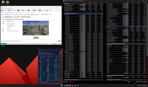

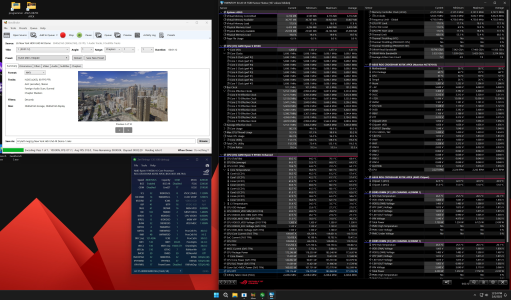

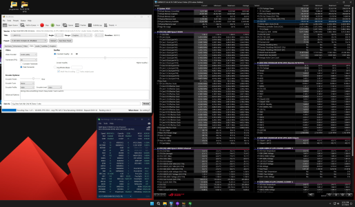

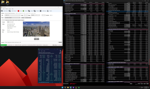

I ran the test using the 65W Eco mode on my 9950X. 6.7W/fps. I'll add it to the chart next update.
BTW, "65 Watt Eco Mode" refers to the cores power. Package power was 87.6W average.
I have also done some efficieny runs :)
16 cores / 32 threads @ 250w PPT limit
HandBrake 1.3.3 (2020061300)
OS: Microsoft Windows NT 10.0.22631.0
CPU: AMD Ryzen 9 9950X 16-Core Processor
Ram: 32402 MB,
GPU Information:
Microsoft Basic Display Adapter - 10.0.22621.1
Screen: 3840x2160
Temp Dir: C:\Users\Administrator\AppData\Local\Temp\
Install Dir: H:\Clean install Windows 11\5950x\programmer\Handbreak\Handbreak 1.33\HandBrake
Data Dir: C:\Users\Administrator\AppData\Roaming\HandBrake

[12:55:53] work: average encoding speed for job is 21.939983 fps
[12:55:53] comb detect: heavy 1091 | light 277 | uncombed 438 | total 1806
[12:55:53] decomb: deinterlaced 1091 | blended 277 | unfiltered 438 | total 1806
[12:55:53] vfr: 1806 frames output, 0 dropped and 0 duped for CFR/PFR
[12:55:53] vfr: lost time: 0 (0 frames)
[12:55:53] vfr: gained time: 0 (0 frames) (0 not accounted for)
[12:55:53] aac-decoder done: 3384 frames, 0 decoder errors
[12:55:53] hevc-decoder done: 1806 frames, 0 decoder errors
[12:55:53] sync: got 1806 frames, 1803 expected
[12:55:53] sync: framerate min 25.000 fps, max 25.000 fps, avg 25.000 fps
encoded 1806 frames in 83.73s (21.57 fps), 11820.04 kb/s, Avg QP:29.09
[12:55:53] mux: track 0, 1806 frames, 106742176 bytes, 11814.30 kbps, fifo 512
[12:55:53] mux: track 1, 3385 frames, 1365514 bytes, 151.14 kbps, fifo 1024
[12:55:53] Finished work at: Thu Feb 06 12:55:53 2025
[12:55:53] libhb: work result = 0
16 cores / 32 threads @ 150w PPT limit
Ram: 32402 MB,
GPU Information:
Screen: 3840x2160

Det0x
Sep 11, 2014
1,490
5,117
I would love for @Det0x to do this with avx-512 enabled. I think its a better implementation than the 11 series Intel for avx-512
I will re-run when i get home from work 👍
@Hulk
Could you please update specifications on the chart for my latest runs this week -> 16/32 Custom watercooling - 32gigs adie @ 8500 CL32-47-41-61
cpu is not delidded, and its not running mem at 8200 like scoreboard says)
I'm not sure why Det0x's efficiency GHz/fps went from 0.255 for his best run to 0.260 for the second fast run and really as fast as his fastest run but with less clocks and 40W less power. Strange.
Kinda makes sense since those runs were done with autoboost PBO..
Hwinfo is not quick enough to catch the large clockspeed fluctuation, especially when PPT power capped
2.55 is with static OC which shows "real clockspeed".
2.60 is with PBO

Have you ever tried to enable AVX512? It could give you up to 10% to scores on compatible CPUs. I mean your logs show
which is expected as x265 disables avx512 by default (thank you Skylake-X).
Last time i checked, AVX512 has no effect in Handbrake 1.3.3 as I stated here https://forums.anandtech.com/thread...te-overhaul-of-the-test.2588294/post-41303622
So a newer version than 1.3.3 (I used 1.8.2) is needed to see AVX512 improvement with x265 encoding
AVX512 did actually help out a tiny bit in handbrake1.33 for the 9950X ;)
Went from 22.75 FPS to 24.51 FPS when maxed out on PBO tune :cool:
16/32 AVX512 with PBO curve optimizer maxed out
16/32 AVX2 with PBO curve optimizer maxed out @ handbrake 1.9
HandBrake 1.9.0 (2024120100)

[12:24:32] work: average encoding speed for job is 23.590202 fps

encoded 1806 frames in 78.01s (23.15 fps), 11613.36 kb/s, Avg QP:29.02

16/32 AVX512 with PBO curve optimizer maxed out @ handbrake 1.9

"Options": "strong-intra-smoothing=0:rect=0:aq-mode=1:asm=avx512",

[12:51:01] reader: done. 1 scr changes
[12:51:05] work: average encoding speed for job is 25.279800 fps
[12:51:05] comb detect: heavy 567 | light 209 | uncombed 1030 | total 1806
[12:51:05] decomb: deinterlaced 567 | blended 209 | unfiltered 1030 | total 1806
[12:51:05] vfr: 1806 frames output, 0 dropped and 0 duped for CFR/PFR
[12:51:05] vfr: lost time: 0 (0 frames)
[12:51:05] vfr: gained time: 0 (0 frames) (0 not accounted for)
[12:51:05] aac-decoder done: 3384 frames, 0 decoder errors
[12:51:05] hevc-decoder done: 1806 frames, 0 decoder errors
[12:51:05] sync: got 1806 frames, 1803 expected
[12:51:05] sync: framerate min 25.000 fps, max 25.000 fps, avg 25.000 fps
x265 [info]: frame I: 20, Avg QP:22.76 kb/s: 83292.44
x265 [info]: frame P: 439, Avg QP:24.58 kb/s: 28577.59
x265 [info]: frame B: 1347, Avg QP:30.56 kb/s: 5020.29
x265 [info]: Weighted P-Frames: Y:16.2% UV:11.6%
encoded 1806 frames in 72.94s (24.76 fps), 11613.36 kb/s, Avg QP:29.02

AVX512 did actually help alittle in Handbreak 1.33 for the 9950X ;)
Went from 22.75 FPS to 24.51 FPS when maxed out on PBP tune :cool:

[11:59:44] + color profile: 9-16-9
[11:59:44] * audio track 1
[11:59:44] + decoder: Unknown (AAC LC) (2.0 ch) (192 kbps) (track 1, id 0x1)
[11:59:44] + bitrate: 192 kbps, samplerate: 48000 Hz
[11:59:44] + mixdown: Stereo
[11:59:44] + dither: none
[11:59:44] + encoder: AAC (libavcodec)
[11:59:44] + bitrate: 160 kbps, samplerate: 48000 Hz
[11:59:44] file is MPEG Transport Stream with 188 byte packets offset 0 bytes
[11:59:44] hb_ts_stream_find_pids - end of file
[11:59:44] sync: expecting 1803 video frames
x265 [info]: HEVC encoder version 3.2.1+1-b5c86a64bbbe
x265 [info]: build info [Windows][GCC 9.2.0][64 bit] 8bit+10bit+12bit
x265 [info]: using cpu capabilities: MMX2 SSE2Fast LZCNT SSSE3 SSE4.2 AVX FMA3 BMI2 AVX2 AVX512
x265 [info]: Main profile, Level-5 (Main tier)
x265 [info]: Thread pool created using 32 threads
x265 [info]: Slices : 1
x265 [info]: frame threads / pool features : 6 / wpp(34 rows)
x265 [info]: Coding QT: max CU size, min CU size : 64 / 8
x265 [info]: Residual QT: max TU size, max depth : 32 / 1 inter / 1 intra
x265 [info]: ME / range / subpel / merge : star / 57 / 3 / 3
x265 [info]: Keyframe min / max / scenecut / bias: 25 / 250 / 40 / 5.00
x265 [info]: Lookahead / bframes / badapt : 25 / 4 / 2
x265 [info]: b-pyramid / weightp / weightb : 1 / 1 / 0
x265 [info]: References / ref-limit cu / depth : 4 / on / on
x265 [info]: AQ: mode / str / qg-size / cu-tree : 1 / 1.0 / 32 / 1
x265 [info]: Rate Control / qCompress : CRF-24.0 / 0.60
x265 [info]: tools: limit-modes rd=4 psy-rd=2.00 rdoq=2 psy-rdoq=1.00 rskip
x265 [info]: tools: signhide tmvp lslices=4 deblock sao
[11:59:44] sync: first pts video is 0
[11:59:44] sync: "Chapter 1" (1) at frame 1 time 0
[11:59:44] sync: first pts audio 0x1 is 0
[12:00:54] reader: done. 1 scr changes
[12:00:57] work: average encoding speed for job is 24.879637 fps
[12:00:57] comb detect: heavy 1091 | light 277 | uncombed 438 | total 1806
[12:00:57] decomb: deinterlaced 1091 | blended 277 | unfiltered 438 | total 1806
[12:00:57] vfr: 1806 frames output, 0 dropped and 0 duped for CFR/PFR
[12:00:57] vfr: lost time: 0 (0 frames)
[12:00:57] vfr: gained time: 0 (0 frames) (0 not accounted for)
[12:00:57] aac-decoder done: 3384 frames, 0 decoder errors
[12:00:57] hevc-decoder done: 1806 frames, 0 decoder errors
[12:00:57] sync: got 1806 frames, 1803 expected
[12:00:57] sync: framerate min 25.000 fps, max 25.000 fps, avg 25.000 fps
encoded 1806 frames in 73.68s (24.51 fps), 11820.04 kb/s, Avg QP:29.09
[12:00:57] mux: track 0, 1806 frames, 106742176 bytes, 11814.30 kbps, fifo 512
[12:00:57] mux: track 1, 3385 frames, 1365514 bytes, 151.14 kbps, fifo 1024
[12:00:57] Finished work at: Fri Feb 07 12:00:57 2025
[12:00:57] libhb: work result = 0
it seems I need to retest AVX512 with 1.3.3 version :p
28,174
19,219
I think that's enough handbrake benching for awhile :sweatsmile:
But but but what if the SMT phantom threads are sucking the lifeblood out of the physical AVX-512 registers???
I think one more run with handbrake 1.9 and SMT off + AVX-512 on, is warranted :p
Reactions: Det0x
MarkPost
Mar 1, 2017
378
794
Some thoughts.
ArrogantHair's 285K and my 9950X at stock are neck-and-neck encoding x265 in terms of performance and efficiency at 200W. The 285K is a good option for encoding.
well ArrogantHair's 285K isnt stock (E-Cores are oced to 5.0 from 4.6) and isnt consumig 200w on average while running the encoding bench but while he has hwinfo open (which is for a longer time than the encoding task). Looking at peak, it is 285W, so I guess that encoding average power consumption for his 285K really is 265-275W. Far from efficient.
