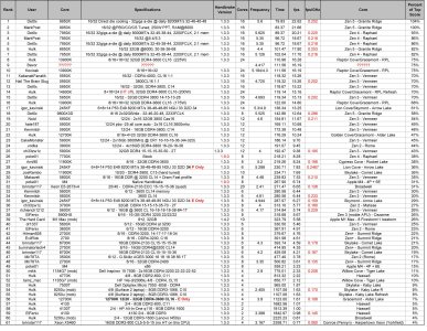

I went through all of the results and created a new table. In respecting everyone's time who participated in the old data I am keeping that data on the 2nd page of this post.

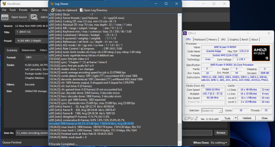

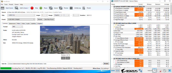

2. Report your encoding time, average CPU frequency, and Package Power. If you have a hybrid CPU you can turn off the E's in the BIOS. For E testing turn off all P's except one in the BIOS, clock it down to 800MHz, and then shut it down with Process Lasso. Or just report your score with 1 P at 800MHz and let me know you did that so I can subtract out that P core's (minor) contribution to the encode.
Here's how to report your average clock and package power so we are all doing it the same way.
Handbrake does some housekeeping right after you start encode and when the progress bar gets to 100%.
This could result in lower than actual average clock.
After you start the encode, wait a few seconds until you see the green Handbrake bar appear, then reset the HWinfo counter.
At the end don't wait to grab the screen shot at 100%, just do it sometime after about 95%.

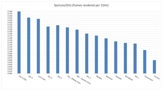

So as you probably know I like to investigate the throughput of various CPU cores with specific workloads. I have reconfigured the Handbrake test a bit to try and measure throughput in terms of how many GHz does a particular core need to render the test file at 1fps.
Thus far I have 3 values.
First, I'm see my 9950X requiring 3.92GHz for each fps of rendering rate. Det0x's 9800X3D is showing 3.5GHz, which is about 12% better than the non vcache Zen 5 core. Now I'm assuming Det0x was running at 5.525GHz?
I also have the isolated E core score from my old 12700K, which I think I ran at 3.9GHz. From that result Gracemont seems to need 9.7GHz to render at 1fps.
If anyone wants to resubmit their scores and let me know their average clock during the run I will update the chart. I suggest resetting HWinfo just after rendering starts and then checking "Core Clocks" average just before the encode finishes.
For hybrids I suggest shutting of E cores in BIOS to test P cores and then shutting off all P cores except 1 and setting that one to 800MHz, making it pretty much irrelevant in the final result. Also, as I've noted before it's easy enough to subtract out that minor contribution once the P core throughput is known.

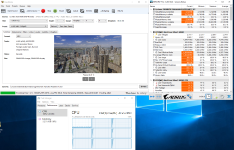

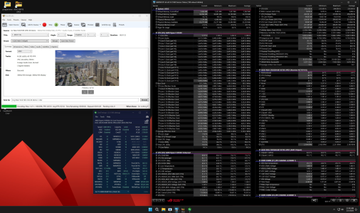

I will do the Lion Coves first since it's the easiest to just turn off the Skymonts but just thinking about only six Lion Coves lazily struggling to finish this heavy encode is unappealing. But science is important! :D
Hulk
5,403
4,111
Lion Cove score: 230.71s (7.83 fps)
Skymont (plus a single Lion Cove) score: 225.23s (8.02 fps)
Process Lasso is unable to help in core performance isolation when the process being lasso'ed involves writing to a file: https://forums.anandtech.com/thread...ying-to-isolate-cpu-core-performance.2625417/
So you will need to subtract the Lion Cove's contribution from the above score.

Also, weird observation in Handbrake with Lion Cove. The percentage progress isn't continuous like on Skymont. It pauses for a second or two and then increments by a larger amount in contrast to the fractional continuous increments on Skymont. Makes it look like the Lion Coves are huddled together in a corner discussing/computing the workload and then turn back together to update what they have done :D

What was the frequency of that single P core?
Checked hwmon log and minimum was 4800 MHz while max was 5300 MHz and it fluctuated a lot. Avg. effective clockspeed came out a bit over 5 GHz. But does it matter now that I have the isolated score for Skymont?

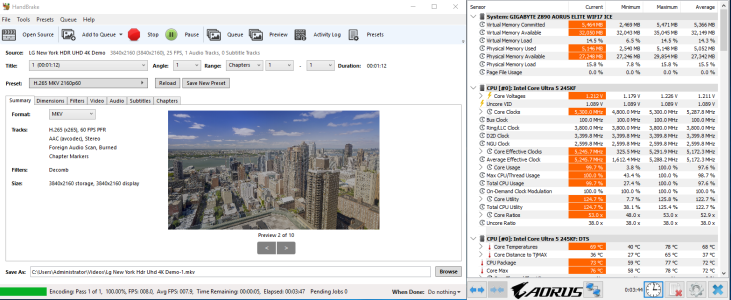

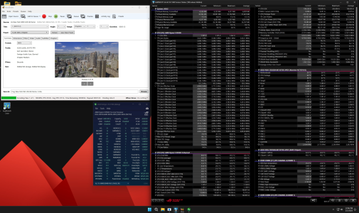

Actual real too good to be true "I can't believe this worked" Skymont Handbrake score!
287.97s (6.27 fps)
28,174
19,218
To recap, here's the comparison between Lion Cove and Skymont:
Lion Cove score (6 cores): 230.71s (7.83 fps)
Skymont score (8 cores): 287.97s (6.27 fps)

I re-worked all of the data. See the first page of this thread for the new data collection request. Basically I'm looking to record frequency, not "effective clock."
All of the old data will stay on the 2nd post of the thread.
Since this is all new, here's the revised data.
Thanks to Igor we have some great data on Lion Cove and Skymont. Skymont appears to be have about 50% better "throughput" per cycle than Gracemont, which seems about right based on the data Intel provided on Skymont.
As more data (hopefully) comes in I will revise the chart. Right now for a given core type I average the "throughput" (fps/GHz/core) scores I have.
I'm not sure why the 9800X3D score is so much better than the regular Zen 5 as L3 shouldn't make a difference I would think with this compute bound benchmark.
One possibility is Handbrake x265 is not scaling well with additional cores after 8 cores so 16 core CPU's are at a bit of a disadvantage here.
I tried to shut down 8 cores on my 9950X but couldn't see where to do that in the BIOS. First AMD rig so still learning my way around.
Finally, if anyone who has a test in the chart but now "fps/GHz/core" result I would need to know the average frequency during your run to complete your results.
Also, I don't have an Alder Lake or Raptor Lake rig anymore so hopefully someone can isolate those P's and E's so we can get some data on them!
Just noticed "Zen 3/4" are out of order on the chart. Also "percent of top score." Will fix next update.

Hulk
5,403
4,111
Just noticed how close Lion Cove is to Zen 5 yet Lion Cove doesn't have HT.
We need more data. Zen 5 w/o HT and a Raptor Cove score with and without HT.

Alrighty, have been rebenching handbreak 1.33 again
  • 9950X @ optimus signature v3 waterblock
  • ROG CROSSHAIR X870E APEX
  • 2x16GB G.Skill Trident 8000 Z5 Royal Neo hynix a-die @ custom heatsinks + 2x noctua 60mm fans ontop
  • memory is running ~8509MT/s CL32 (8400 * 1.013 baseclock)
  • FCLK is running ~2228mhz (2200 * 1.013 baseclock)
  • hwinfo have snapshot pulling mode enabled, not sure how much it lowers performance having it open
Static OC with SMT enabled -> average core clocks = 5571.5 mhz
HandBrake 1.3.3 (2020061300)
OS: Microsoft Windows NT 10.0.22631.0
CPU: AMD Ryzen 9 9950X 16-Core Processor
Ram: 32402 MB,
GPU Information:
Microsoft Basic Display Adapter - 10.0.22621.1
Screen: 3840x2160
Temp Dir: C:\Users\Administrator\AppData\Local\Temp\
Install Dir: H:\Clean install Windows 11\5950x\programmer\Handbreak\Handbreak 1.33\HandBrake
Data Dir: C:\Users\Administrator\AppData\Roaming\HandBrake
# Starting Encode ...
[11:47:01] base preset: H.265 MKV 2160p60
[11:47:01] hb_init: starting libhb thread
[11:47:01] Starting work at: Wed Feb 05 11:47:01 2025
[11:47:01] 1 job(s) to process
[11:47:01] json job:
"Audio": {
"AudioList": [
"Bitrate": 160,
"DRC": 0.0,
"Encoder": "av_aac",
"Gain": 0.0,
"Mixdown": 4,
"NormalizeMixLevel": false,
"Samplerate": 0,
"Track": 0,
"DitherMethod": 0
"CopyMask": [
"copy:aac",
"copy:ac3",
"copy:dtshd",
"copy:dts",
"copy:eac3",
"copy:flac",
"copy:mp3",
"copy:truehd"
"FallbackEncoder": "ac3"
"Destination": {
"ChapterList": [
"Name": "Chapter 1"
"ChapterMarkers": true,
"AlignAVStart": false,
"File": "I:\\Lg New York Hdr Uhd 4K Demo-1.mkv",
"Mp4Options": {
"IpodAtom": false,
"Mp4Optimize": false
"Mux": "av_mkv"
"Filters": {
"FilterList": [
"ID": 4,
"Settings": {
"mode": "7"
"ID": 3,
"Settings": {
"block-height": "16",
"block-thresh": "40",
"block-width": "16",
"filter-mode": "2",
"mode": "3",
"motion-thresh": "1",
"spatial-metric": "2",
"spatial-thresh": "1"
"ID": 12,
"Settings": {
"crop-bottom": "0",
"crop-left": "0",
"crop-right": "0",
"crop-top": "0",
"height": "2160",
"width": "3840"
"ID": 6,
"Settings": {
"mode": "2",
"rate": "27000000/450000"
"PAR": {
"Num": 1,
"Den": 1
"Metadata": {},
"SequenceID": 0,
"Source": {
"Angle": 1,
"Range": {
"Type": "chapter",
"Start": 1,
"End": 1
"Title": 1,
"Path": "H:\\Clean install Windows 11\\5950x\\programmer\\Handbreak\\Handbreak 1.33\\LG New York HDR UHD 4K Demo.ts"
"Subtitle": {
"Search": {
"Burn": true,
"Default": false,
"Enable": true,
"Forced": true
"SubtitleList": []
"Video": {
"Encoder": "x265",
"Level": "auto",
"TwoPass": false,
"Turbo": false,
"ColorMatrixCode": 0,
"Options": "strong-intra-smoothing=0:rect=0:aq-mode=1",
"Preset": "slow",
"Profile": "main",
"Quality": 24.0,
"QSV": {
"Decode": false,
"AsyncDepth": 0
[11:47:01] CPU: AMD Ryzen 9 9950X 16-Core Processor
[11:47:01] - logical processor count: 32
[11:47:01] Intel Quick Sync Video support: no
[11:47:01] hb_scan: path=H:\Clean install Windows 11\5950x\programmer\Handbreak\Handbreak 1.33\LG New York HDR UHD 4K Demo.ts, title_index=1
udfread ERROR: ECMA 167 Volume Recognition failed
src/libbluray/disc/disc.c:323: failed opening UDF image H:\Clean install Windows 11\5950x\programmer\Handbreak\Handbreak 1.33\LG New York HDR UHD 4K Demo.ts
src/libbluray/disc/disc.c:424: error opening file BDMV\index.bdmv
src/libbluray/disc/disc.c:424: error opening file BDMV\BACKUP\index.bdmv
src/libbluray/bluray.c:2585: nav_get_title_list(H:\Clean install Windows 11\5950x\programmer\Handbreak\Handbreak 1.33\LG New York HDR UHD 4K Demo.ts\) failed
[11:47:01] bd: not a bd - trying as a stream/file instead
libdvdnav: Using dvdnav version 6.0.1
libdvdread: Encrypted DVD support unavailable.
libdvdread:DVDOpenFileUDF:UDFFindFile /VIDEO_TS/VIDEO_TS.IFO failed
libdvdread:DVDOpenFileUDF:UDFFindFile /VIDEO_TS/VIDEO_TS.BUP failed
libdvdread: Can't open file VIDEO_TS.IFO.
libdvdnav: vm: failed to read VIDEO_TS.IFO
[11:47:01] dvd: not a dvd - trying as a stream/file instead
[11:47:01] file is MPEG Transport Stream with 188 byte packets offset 0 bytes
[11:47:01] hb_ts_stream_find_pids - end of file
Input #0, mpegts, from 'H:\Clean install Windows 11\5950x\programmer\Handbreak\Handbreak 1.33\LG New York HDR UHD 4K Demo.ts':
Duration: 00:01:12.15, start: 0.999989, bitrate: 52098 kb/s
Program 1
Stream #0:0[0x101]: Video: hevc (Main 10) ([36][0][0][0] / 0x0024), yuv420p10le(tv, bt2020nc/bt2020/smpte2084), 3840x2160 [SAR 1:1 DAR 16:9], 25 fps, 25 tbr, 90k tbn, 25 tbc
Stream #0:1[0x102](und): Audio: aac (LC) ([15][0][0][0] / 0x000F), 48000 Hz, stereo, fltp, 192 kb/s
[11:47:01] scan: decoding previews for title 1
[11:47:01] scan: audio 0x1: aac, rate=48000Hz, bitrate=192000 Unknown (AAC LC) (2.0 ch) (192 kbps)
[11:47:03] scan: 10 previews, 3840x2160, 25.000 fps, autocrop = 0/0/0/0, aspect 16:9, PAR 1:1
[11:47:03] scan: supported video decoders: avcodec qsv
[11:47:03] libhb: scan thread found 1 valid title(s)
[11:47:03] Skipping subtitle scan. No suitable subtitle tracks.
[11:47:03] Starting Task: Encoding Pass
[11:47:03] Skipping crop/scale filter
[11:47:03] work: only 1 chapter, disabling chapter markers
[11:47:03] job configuration:
[11:47:03] * source
[11:47:03] + H:\Clean install Windows 11\5950x\programmer\Handbreak\Handbreak 1.33\LG New York HDR UHD 4K Demo.ts
[11:47:03] + title 1, chapter(s) 1 to 1
[11:47:03] + container: mpegts
[11:47:03] + data rate: 52098 kbps
[11:47:03] * destination
[11:47:03] + I:\Lg New York Hdr Uhd 4K Demo-1.mkv
[11:47:03] + container: Matroska (libavformat)
[11:47:03] * video track
[11:47:03] + decoder: hevc
[11:47:03] + filters
[11:47:03] + Comb Detect (mode=3:spatial-metric=2:motion-thresh=1:spatial-thresh=1:filter-mode=2:block-thresh=40:block-width=16:block-height=16)
[11:47:03] + Decomb (mode=39)
[11:47:03] + Framerate Shaper (mode=2:rate=27000000/450000)
[11:47:03] + frame rate: 25.000 fps -> peak rate limited to 60.000 fps
[11:47:03] + Output geometry
[11:47:03] + storage dimensions: 3840 x 2160
[11:47:03] + pixel aspect ratio: 1 : 1
[11:47:03] + display dimensions: 3840 x 2160
[11:47:03] + encoder: H.265 (libx265)
[11:47:03] + preset: slow
[11:47:03] + options: strong-intra-smoothing=0:rect=0:aq-mode=1
[11:47:03] + profile: main
[11:47:03] + level: auto
[11:47:03] + quality: 24.00 (RF)
[11:47:03] + color profile: 9-16-9
[11:47:03] * audio track 1
[11:47:03] + decoder: Unknown (AAC LC) (2.0 ch) (192 kbps) (track 1, id 0x1)
[11:47:03] + bitrate: 192 kbps, samplerate: 48000 Hz
[11:47:03] + mixdown: Stereo
[11:47:03] + dither: none
[11:47:03] + encoder: AAC (libavcodec)
[11:47:03] + bitrate: 160 kbps, samplerate: 48000 Hz
[11:47:03] file is MPEG Transport Stream with 188 byte packets offset 0 bytes
[11:47:03] hb_ts_stream_find_pids - end of file
[11:47:03] sync: expecting 1803 video frames
x265 [info]: HEVC encoder version 3.2.1+1-b5c86a64bbbe
x265 [info]: build info [Windows][GCC 9.2.0][64 bit] 8bit+10bit+12bit
x265 [info]: using cpu capabilities: MMX2 SSE2Fast LZCNT SSSE3 SSE4.2 AVX FMA3 BMI2 AVX2
x265 [info]: Main profile, Level-5 (Main tier)
x265 [info]: Thread pool created using 32 threads
x265 [info]: Slices : 1
x265 [info]: frame threads / pool features : 6 / wpp(34 rows)
x265 [info]: Coding QT: max CU size, min CU size : 64 / 8
x265 [info]: Residual QT: max TU size, max depth : 32 / 1 inter / 1 intra
x265 [info]: ME / range / subpel / merge : star / 57 / 3 / 3
x265 [info]: Keyframe min / max / scenecut / bias: 25 / 250 / 40 / 5.00
x265 [info]: Lookahead / bframes / badapt : 25 / 4 / 2
x265 [info]: b-pyramid / weightp / weightb : 1 / 1 / 0
x265 [info]: References / ref-limit cu / depth : 4 / on / on
x265 [info]: AQ: mode / str / qg-size / cu-tree : 1 / 1.0 / 32 / 1
x265 [info]: Rate Control / qCompress : CRF-24.0 / 0.60
x265 [info]: tools: limit-modes rd=4 psy-rd=2.00 rdoq=2 psy-rdoq=1.00 rskip
x265 [info]: tools: signhide tmvp lslices=4 deblock sao
[11:47:03] sync: first pts video is 0
[11:47:03] sync: "Chapter 1" (1) at frame 1 time 0
[11:47:03] sync: first pts audio 0x1 is 0
[11:48:18] reader: done. 1 scr changes
[11:48:22] work: average encoding speed for job is 23.044758 fps
[11:48:22] comb detect: heavy 1091 | light 277 | uncombed 438 | total 1806
[11:48:22] decomb: deinterlaced 1091 | blended 277 | unfiltered 438 | total 1806
[11:48:22] vfr: 1806 frames output, 0 dropped and 0 duped for CFR/PFR
[11:48:22] vfr: lost time: 0 (0 frames)
[11:48:22] vfr: gained time: 0 (0 frames) (0 not accounted for)
[11:48:22] aac-decoder done: 3384 frames, 0 decoder errors
[11:48:22] hevc-decoder done: 1806 frames, 0 decoder errors
[11:48:22] sync: got 1806 frames, 1803 expected
[11:48:22] sync: framerate min 25.000 fps, max 25.000 fps, avg 25.000 fps
x265 [info]: frame I: 20, Avg QP:22.74 kb/s: 84168.04
x265 [info]: frame P: 426, Avg QP:24.64 kb/s: 29918.47
x265 [info]: frame B: 1360, Avg QP:30.58 kb/s: 5087.03
x265 [info]: Weighted P-Frames: Y:15.7% UV:11.0%
x265 [info]: consecutive B-frames: 9.6% 1.8% 7.6% 35.9% 45.1%
encoded 1806 frames in 79.48s (22.72 fps), 11820.04 kb/s, Avg QP:29.09
[11:48:23] mux: track 0, 1806 frames, 106742176 bytes, 11814.30 kbps, fifo 512
[11:48:23] mux: track 1, 3385 frames, 1365514 bytes, 151.14 kbps, fifo 1024
[11:48:23] Finished work at: Wed Feb 05 11:48:23 2025
[11:48:23] libhb: work result = 0
# Encode Completed ...
Static OC with SMT disabled -> average core clocks = 5622.1 mhz
Ram: 32402 MB,
GPU Information:
Screen: 3840x2160

[12:04:27] Skipping subtitle scan. No suitable subtitle tracks.
[12:04:27] Starting Task: Encoding Pass
[12:04:27] Skipping crop/scale filter
[12:04:27] work: only 1 chapter, disabling chapter markers
[12:04:27] job configuration:
[12:04:27] * source
[12:04:27] + H:\Clean install Windows 11\5950x\programmer\Handbreak\Handbreak 1.33\LG New York HDR UHD 4K Demo.ts
[12:04:27] + title 1, chapter(s) 1 to 1
[12:04:27] + container: mpegts
[12:04:27] + data rate: 52098 kbps
[12:04:27] * destination
[12:04:27] + I:\Lg New York Hdr Uhd 4K Demo-1.mkv
[12:04:27] + container: Matroska (libavformat)
[12:04:27] * video track
[12:04:27] + decoder: hevc
[12:04:27] + filters
[12:04:27] + Comb Detect (mode=3:spatial-metric=2:motion-thresh=1:spatial-thresh=1:filter-mode=2:block-thresh=40:block-width=16:block-height=16)
[12:04:27] + Decomb (mode=39)
[12:04:27] + Framerate Shaper (mode=2:rate=27000000/450000)
[12:04:27] + frame rate: 25.000 fps -> peak rate limited to 60.000 fps
[12:04:27] + Output geometry
[12:04:27] + storage dimensions: 3840 x 2160
[12:04:27] + pixel aspect ratio: 1 : 1
[12:04:27] + display dimensions: 3840 x 2160
[12:04:27] + encoder: H.265 (libx265)
[12:04:27] + preset: slow
[12:04:27] + options: strong-intra-smoothing=0:rect=0:aq-mode=1
[12:04:27] + profile: main
[12:04:27] + level: auto
[12:04:27] + quality: 24.00 (RF)
[12:04:27] + color profile: 9-16-9
[12:04:27] * audio track 1
[12:04:27] + decoder: Unknown (AAC LC) (2.0 ch) (192 kbps) (track 1, id 0x1)
[12:04:27] + bitrate: 192 kbps, samplerate: 48000 Hz
[12:04:27] + mixdown: Stereo
[12:04:27] + dither: none
[12:04:27] + encoder: AAC (libavcodec)
[12:04:27] + bitrate: 160 kbps, samplerate: 48000 Hz
[12:04:27] file is MPEG Transport Stream with 188 byte packets offset 0 bytes
[12:04:28] hb_ts_stream_find_pids - end of file
[12:04:28] sync: expecting 1803 video frames
x265 [info]: Thread pool created using 16 threads
x265 [info]: frame threads / pool features : 4 / wpp(34 rows)
[12:04:28] sync: first pts video is 0
[12:04:28] sync: "Chapter 1" (1) at frame 1 time 0
[12:04:28] sync: first pts audio 0x1 is 0
[12:06:07] reader: done. 1 scr changes
[12:06:11] work: average encoding speed for job is 17.628624 fps
[12:06:11] comb detect: heavy 1091 | light 277 | uncombed 438 | total 1806
[12:06:11] decomb: deinterlaced 1091 | blended 277 | unfiltered 438 | total 1806
[12:06:11] vfr: 1806 frames output, 0 dropped and 0 duped for CFR/PFR
[12:06:11] vfr: lost time: 0 (0 frames)
[12:06:11] vfr: gained time: 0 (0 frames) (0 not accounted for)
[12:06:11] aac-decoder done: 3384 frames, 0 decoder errors
[12:06:11] hevc-decoder done: 1806 frames, 0 decoder errors
[12:06:11] sync: got 1806 frames, 1803 expected
[12:06:11] sync: framerate min 25.000 fps, max 25.000 fps, avg 25.000 fps
encoded 1806 frames in 103.83s (17.39 fps), 11820.04 kb/s, Avg QP:29.09
[12:06:11] mux: track 0, 1806 frames, 106742176 bytes, 11814.30 kbps, fifo 512
[12:06:11] mux: track 1, 3385 frames, 1365514 bytes, 151.14 kbps, fifo 1024
[12:06:11] Finished work at: Wed Feb 05 12:06:11 2025
[12:06:11] libhb: work result = 0
PBO curve optimizer with SMT enabled
(hwinfo not quick enough to catch the large clockspeed fluctuation)

[12:22:58] work: average encoding speed for job is 23.080290 fps
[12:22:58] comb detect: heavy 1091 | light 277 | uncombed 438 | total 1806
[12:22:59] decomb: deinterlaced 1091 | blended 277 | unfiltered 438 | total 1806
[12:22:59] vfr: 1806 frames output, 0 dropped and 0 duped for CFR/PFR
[12:22:59] vfr: lost time: 0 (0 frames)
[12:22:59] vfr: gained time: 0 (0 frames) (0 not accounted for)
[12:22:59] aac-decoder done: 3384 frames, 0 decoder errors
[12:22:59] hevc-decoder done: 1806 frames, 0 decoder errors
[12:22:59] sync: got 1806 frames, 1803 expected
[12:22:59] sync: framerate min 25.000 fps, max 25.000 fps, avg 25.000 fps
encoded 1806 frames in 79.40s (22.75 fps), 11820.04 kb/s, Avg QP:29.09
Ram: 32402 MB,
GPU Information:
Screen: 3840x2160
"Audio": {
"AudioList": [
"Bitrate": 160,
"DRC": 0.0,
"Gain": 0.0,
"Mixdown": 4,
"Samplerate": 0,
"Track": 0,
"DitherMethod": 0
"CopyMask": [
"copy:aac",
"copy:ac3",
"copy:dtshd",
"copy:dts",
"copy:eac3",
"copy:flac",
"copy:mp3",
"copy:truehd"
"Destination": {
"ChapterList": [
"Name": "Chapter 1"
"Mp4Options": {
"IpodAtom": false,
"Mux": "av_mkv"
"Filters": {
"FilterList": [
"ID": 4,
"Settings": {
"mode": "7"
"ID": 3,
"Settings": {
"filter-mode": "2",
"mode": "3",
"ID": 12,
"Settings": {
"crop-bottom": "0",
"crop-left": "0",
"crop-right": "0",
"crop-top": "0",
"height": "2160",
"width": "3840"
"ID": 6,
"Settings": {
"mode": "2",
"PAR": {
"Num": 1,
"Den": 1
"Metadata": {},
"SequenceID": 0,
"Source": {
"Angle": 1,
"Range": {
"Type": "chapter",
"Start": 1,
"End": 1
"Title": 1,
"Subtitle": {
"Search": {
"Burn": true,
"Default": false,
"Enable": true,
"Forced": true
"SubtitleList": []
"Video": {
"Encoder": "x265",
"Level": "auto",
"TwoPass": false,
"Turbo": false,
"Preset": "slow",
"Profile": "main",
"Quality": 24.0,
"QSV": {
"Decode": false,
"AsyncDepth": 0
Program 1
[11:47:03] * source

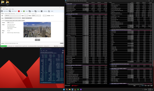

Ram: 32402 MB,
GPU Information:
Screen: 3840x2160
[12:04:25] base preset: H.265 MKV 2160p60
[12:04:25] hb_init: starting libhb thread
[12:04:25] Starting work at: Wed Feb 05 12:04:25 2025
[12:04:25] 1 job(s) to process
[12:04:25] json job:
"Audio": {
"AudioList": [
"Bitrate": 160,
"DRC": 0.0,
"Gain": 0.0,
"Mixdown": 4,
"Samplerate": 0,
"Track": 0,
"DitherMethod": 0
"CopyMask": [
"copy:aac",
"copy:ac3",
"copy:dtshd",
"copy:dts",
"copy:eac3",
"copy:flac",
"copy:mp3",
"copy:truehd"
"Destination": {
"ChapterList": [
"Name": "Chapter 1"
"Mp4Options": {
"IpodAtom": false,
"Mux": "av_mkv"
"Filters": {
"FilterList": [
"ID": 4,
"Settings": {
"mode": "7"
"ID": 3,
"Settings": {
"filter-mode": "2",
"mode": "3",
"ID": 12,
"Settings": {
"crop-bottom": "0",
"crop-left": "0",
"crop-right": "0",
"crop-top": "0",
"height": "2160",
"width": "3840"
"ID": 6,
"Settings": {
"mode": "2",
"PAR": {
"Num": 1,
"Den": 1
"Metadata": {},
"SequenceID": 0,
"Source": {
"Angle": 1,
"Range": {
"Type": "chapter",
"Start": 1,
"End": 1
"Title": 1,
"Subtitle": {
"Search": {
"Burn": true,
"Default": false,
"Enable": true,
"Forced": true
"SubtitleList": []
"Video": {
"Encoder": "x265",
"Level": "auto",
"TwoPass": false,
"Turbo": false,
"Preset": "slow",
"Profile": "main",
"Quality": 24.0,
"QSV": {
"Decode": false,
"AsyncDepth": 0
[12:04:25] CPU: AMD Ryzen 9 9950X 16-Core Processor
[12:04:25] - logical processor count: 16
[12:04:25] Intel Quick Sync Video support: no
[12:04:25] hb_scan: path=H:\Clean install Windows 11\5950x\programmer\Handbreak\Handbreak 1.33\LG New York HDR UHD 4K Demo.ts, title_index=1
[12:04:25] bd: not a bd - trying as a stream/file instead
[12:21:40] sync: first pts video is 0
[12:21:40] sync: "Chapter 1" (1) at frame 1 time 0
[12:21:40] sync: first pts audio 0x1 is 0
[12:22:55] reader: done. 1 scr changes
[12:22:59] mux: track 0, 1806 frames, 106742176 bytes, 11814.30 kbps, fifo 512
[12:22:59] mux: track 1, 3385 frames, 1365514 bytes, 151.14 kbps, fifo 1024
[12:22:59] Finished work at: Wed Feb 05 12:22:59 2025
[12:22:59] libhb: work result = 0
Thanks. Results updated with Package Power and efficiency.
We really need some Raptor Lake and Alder Lake core isolated results...

The 9800X3D throughput advantage of 14% in the chart might be real.
I did some calculations using TechPowerUp x265 encoding benches and they are showing a 9% advantage for the 9800X3d vs the 9700X. Yes, I took the clockspeed difference into account. I don't know the exact clocks they were at during their test so I used the max clocks TechPowerUp found during testing for my calculations.
Regardless, when the 9950X3D arrives I think we will have a new CPU at the top of the charts.
Reactions: lightmanek
