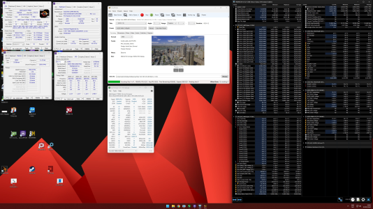

2. Report your encoding time, average CPU frequency, and Package Power. If you have a hybrid CPU you can turn off the E's in the BIOS. For E testing turn off all P's except one in the BIOS, clock it down to 800MHz, and then shut it down with Process Lasso. Or just report your score with 1 P at 800MHz and let me know you did that so I can subtract out that P core's (minor) contribution to the encode.
Here's how to report your average clock and package power so we are all doing it the same way.
Handbrake does some housekeeping right after you start encode and when the progress bar gets to 100%.
This could result in lower than actual average clock.
After you start the encode, wait a few seconds until you see the green Handbrake bar appear, then reset the HWinfo counter.
At the end don't wait to grab the screen shot at 100%, just do it sometime after about 95%.

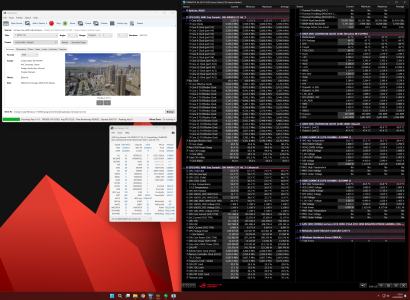

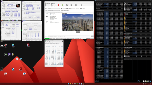

Fifth attempt (in the fourth I forgot the slow memory after loading dafaults in the bios). Now it did not throttle. Completely stock setting including the ridiculous max power draw enabled.
HandBrake 1.3.3 (2020061300)
OS: Microsoft Windows NT 10.0.22621.0
CPU: 13th Gen Intel(R) Core(TM) i9-13900K
Ram: 32535 MB,
GPU Information:
Intel(R) UHD Graphics - 31.0.101.3302
Screen: 3840x2160
Temp Dir: C:\Users\stepa\AppData\Local\Temp\
Install Dir: C:\Prog\HandBrake-1.3.3-x86_64-Win_GUI
Data Dir: C:\Users\stepa\AppData\Roaming\HandBrake
# Starting Encode ...
[10:49:46] base preset: H.265 MKV 2160p60

[22:51:33] reader: done. 1 scr changes
[22:51:39] work: average encoding speed for job is 16.422640 fps

I don't think it was using all 32 cores and 64 threads through the encoding process. I remember this version of handbrake not using all cores threads of higher core count CPUs in the past. When I ran the encoding again, I opened up task manager and go to the performance tab, the CPU utilization isn't near 100%.
I reset the HWINFO64 info right before encoding and hit the print screen key right after it finished for the HWINFO64 information. The CPU clock speed info is correct, its 4.425 all core.
encoded 1806 frames in 108.54s (16.64 fps), 11820.04 kb/s, Avg QP:29.09
end of log:

Hulk
5,404
4,113
end of log:
[15:01:09] sync: first pts video is 0
[15:01:09] sync: "Chapter 1" (1) at frame 1 time 0
[15:01:09] sync: first pts audio 0x1 is 0
[15:02:47] reader: done. 1 scr changes
[15:02:53] work: average encoding speed for job is 17.603903 fps
[15:02:53] comb detect: heavy 1091 | light 277 | uncombed 438 | total 1806
[15:02:53] decomb: deinterlaced 1091 | blended 277 | unfiltered 438 | total 1806
[15:02:53] vfr: 1806 frames output, 0 dropped and 0 duped for CFR/PFR
[15:02:53] vfr: lost time: 0 (0 frames)
[15:02:53] vfr: gained time: 0 (0 frames) (0 not accounted for)
[15:02:53] aac-decoder done: 3384 frames, 0 decoder errors
[15:02:53] hevc-decoder done: 1806 frames, 0 decoder errors
[15:02:54] sync: got 1806 frames, 1803 expected
[15:02:54] sync: framerate min 25.000 fps, max 25.000 fps, avg 25.000 fps
x265 [info]: frame I: 20, Avg QP:22.74 kb/s: 84168.04
x265 [info]: frame P: 426, Avg QP:24.64 kb/s: 29918.47
x265 [info]: frame B: 1360, Avg QP:30.58 kb/s: 5087.03
x265 [info]: Weighted P-Frames: Y:15.7% UV:11.0%
x265 [info]: consecutive B-frames: 9.6% 1.8% 7.6% 35.9% 45.1%
encoded 1806 frames in 104.98s (17.20 fps), 11820.04 kb/s, Avg QP:29.09
[15:02:54] mux: track 0, 1806 frames, 106742176 bytes, 11814.30 kbps, fifo 512
[15:02:54] mux: track 1, 3385 frames, 1365514 bytes, 151.14 kbps, fifo 1024
[15:02:54] Finished work at: Fri Oct 28 15:02:54 2022
[15:02:54] libhb: work result = 0
# Encode Completed ...

Det0x
Sep 11, 2014
1,488
5,114
7950x3d
encoded 1806 frames in 102.04s (17.70 fps), 11820.04 kb/s, Avg QP:29.09

I also tried with newest handbreak 1.72 to check if there were any major differences
encoded 1806 frames in 87.28s (20.69 fps), 11612.17 kb/s, Avg QP:29.03
