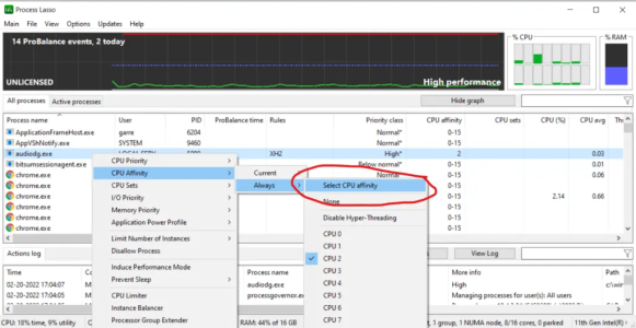

No. He should be good if he
1) Turns off HT and enables only one P-core and enables all E-cores
2) runs Process Lasso in Forced mode https://bitsum.com/processlasso-docs/forced-mode/ (works in Free version)
3) changes the "Always" affinity of Handbrake.exe by unchecking only the first core
4) keeps Task Manager open during the run to ensure that the first core has no work happening on it

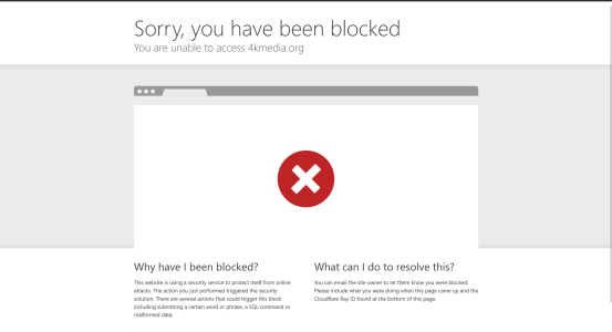

Hulk it is banned in my country had to use a VPN and I am downloading it at whooping 200KB/s

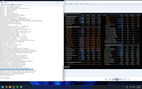

btw I tested in one of my videos where i killed Malenia in Elden ring in NG+1738854919865.png
511
Jul 12, 2024
5,484
4,896
It's impossible for P core to not interfere it still sneaks in for the E core testing even after forcing affinity

That shouldn't be possible. Can you show what settings you chose in Process Lasso? It should be Forced and then use the Always option to uncheck the cores you don't want.

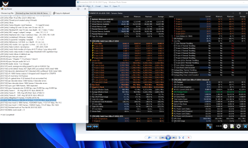

Here is it 6 RWC Version
Let me make sure I'm understanding this result correctly.
This is a 185H mobile processor.
You shut off the 8 E's.
6 P's were running at an average frequency of 3.9 GHz.
2 LPE's were running average 1.03GHz
Average package power of 59.2W.
Was HT turned on?
I don't think we can isolate P, E, or LPE performance from this data.
Including the LPE's small contribution this would give a fps/GHz result of 0.194 so I'm assuming HT was off?
If you don't enjoy this kind of testing I know this is a hassle but one possibility to get a better estimate on the isolation numbers is to reduce the number of P's running and run the test again, then using simultaneous equations you have 2 variables and 2 independent equations.
It's a shame process lasso can't isolate some of those cores.
Can't you lock down the P's and run the test just with the LPE's? I know it would take a loooong time, just wondering?
Once we obtain fps/GHz for the LPE's, we can subtract their contribution from the P's, then you can run with everything on to isolate the E's.
Okay, for now can you just run the test stock on your laptop and let us know the time, frequency of all cores, and package power?
Just put up that same screen shot at like 99% and I'll pull out the data.
Either way I understand this is a hassle so thanks for doing this much!
The Es were not doing anything they were just there and HT was off
Was HT turned on?
Yeah
I will do it on weekend I have few things to try

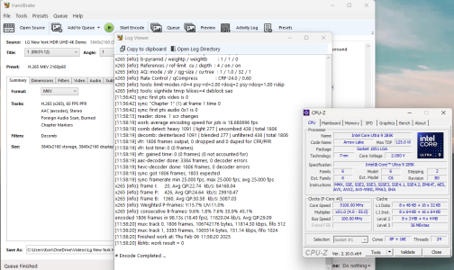

285k 8+16=24 P51 E51 8600 MT/s 40-54-54-134 NGU 34 D2D 36 1.3.3 24 51/51 98.13 18.40 Lion Cove/Skymont - Arrowlake
Not done tweaking. Just on a 360 AIO. Normally run P cores at 54 - dropping to 51 increases encoding speed by 4 seconds, but increases fps by 1.
So P and E cores were running 5.1 during the test? Just want to confirm. You might want to double check that with HWinfo.
Nice score!
ArrogantHair
Feb 6, 2025
53
45
51
Woops - goofed up. P51 E50. Keeps temps down and runs with no throttling. Will re-do with HWinfo.
