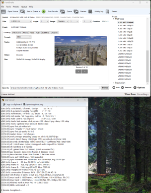

2. Report your encoding time, average CPU frequency, and Package Power. If you have a hybrid CPU you can turn off the E's in the BIOS. For E testing turn off all P's except one in the BIOS, clock it down to 800MHz, and then shut it down with Process Lasso. Or just report your score with 1 P at 800MHz and let me know you did that so I can subtract out that P core's (minor) contribution to the encode.
Here's how to report your average clock and package power so we are all doing it the same way.
Handbrake does some housekeeping right after you start encode and when the progress bar gets to 100%.
This could result in lower than actual average clock.
After you start the encode, wait a few seconds until you see the green Handbrake bar appear, then reset the HWinfo counter.
At the end don't wait to grab the screen shot at 100%, just do it sometime after about 95%.

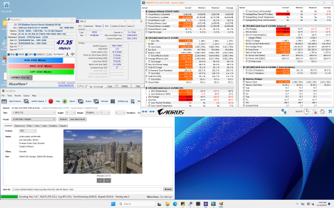

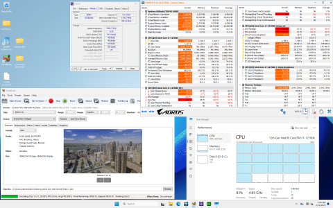

Completed in 174.76s (10.33 fps)
P-core
Completed in 204.24s (8.84 fps).
P-core (HT off)
Completed in 224.69s (8.04 fps).
BONUS P-core HT off AVX off Prefetching off
Completed in 294.38s (6.13 fps).
BONUS run @ 7200 MT/s
Completed in 179.36s (10.07 fps).
Apparently, just bandwidth is not enough. Handbrake wants lower latency too.

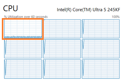

Hey I know it's a long run but could you run the E's on your 245KF again just to be sure? Maybe even run it with 1 P at 800Hz that we can sub out?
28,174
19,219
Sure but I will exclude the P core with Process Lasso. Don't know how to force a certain core to run at a fixed speed.
Reactions: Hulk
Hulk
5,415
4,137
I forget exactly where it is but you can set the multiplier for all of the P cores. You just disable all but one and set it to 8. But if you are getting Process Lasso to shut it down that should work.
But to be sure, try this. Try shutting all of the P's down with Process Lasso (keep them on in BIOS) and see if you get the same result to turning off all P's but one in the BIOS and shutting that one down with Process Lasso.
28,174
19,219

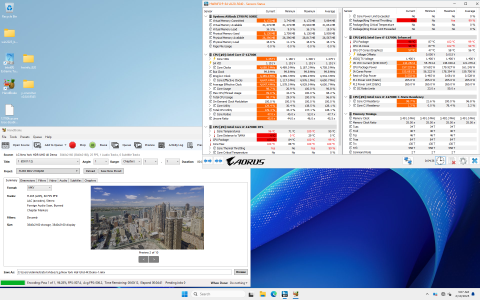

It doesn't shut the core down. The core will do anything except whatever Handbrake is doing. There will be minor less than 2% activity on the lone P-core but it's nothing to do with Handbrake. This is how it looks:
But yeah, this time I will change the multiplier to 8 too, if the Gigabyte BIOS lets me.

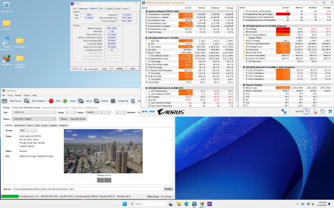

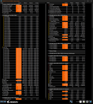

JFC idling 37s? Like I didn't clarify when asked? You can't even see the time stamp.
New run. I changed voltages for P cores (PL1/PL2/Amps increasing wattage), so won't mirror.
Same config P51 E50 R40 N34 D36
Det0x
Sep 11, 2014
1,490
5,121
Now numbers seem more believable 👍
Average powerdraw went from "198.9w" to real 264w
Average clocks went from "4672/4872mhz" to real 5100/5000mhz
This makes alot of difference for the average numbers in the chart, especially for fps/GHZ and watts per fps
ArrogantHair
Feb 6, 2025
53
45
51
Dude. I just tuned it. It wasn't running at 5100/5000mhz (constant) when I ran the previous test because it needed more wattage.
The P-cores were getting insufficient wattage, causing them and the E-Cores to run unstable. There was also thermal throttling, which I eliminated.
The issue with the 1st screen cap is that HWinfo was reset prior to hitting the encode button rather than after, and there was a delay using the snip tool to snap the pic afterward by a couple seconds instead of using Alt-printscreen for the 2nd run. The wattage was real and it was insufficient - the few seconds delay also affected the average.
