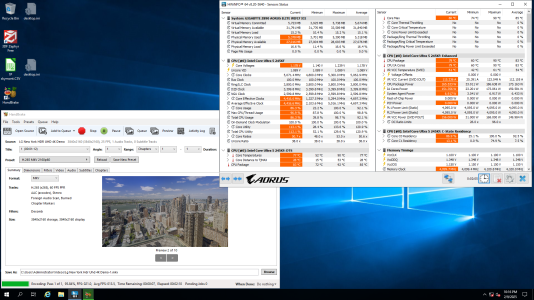

2. Report your encoding time, average CPU frequency, and Package Power. If you have a hybrid CPU you can turn off the E's in the BIOS. For E testing turn off all P's except one in the BIOS, clock it down to 800MHz, and then shut it down with Process Lasso. Or just report your score with 1 P at 800MHz and let me know you did that so I can subtract out that P core's (minor) contribution to the encode.
Here's how to report your average clock and package power so we are all doing it the same way.
Handbrake does some housekeeping right after you start encode and when the progress bar gets to 100%.
This could result in lower than actual average clock.
After you start the encode, wait a few seconds until you see the green Handbrake bar appear, then reset the HWinfo counter.
At the end don't wait to grab the screen shot at 100%, just do it sometime after about 95%.

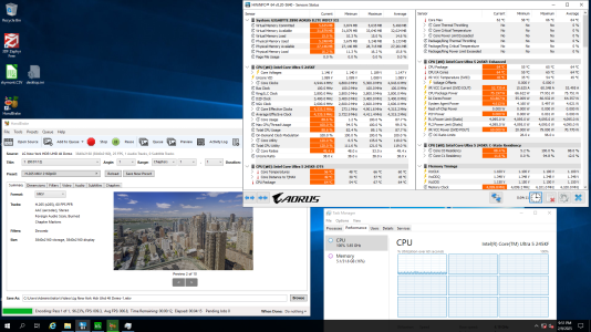

But yeah, this time I will change the multiplier to 8 too, if the Gigabyte BIOS lets me.
Tried it and the P-core did run at 0.8 GHz BUT the entire Skymont cluster next to it decided to take a nap too. Only the 2nd Skymont cluster handled the encode even though all eight E-cores were selected in Process Lasso. Not sure if this is how Intel designed it or whether it's a BIOS limitation.
28,173
19,203
P-cores 231.01s (7.82 fps)
Average clocks
5296.64​
5290.76​
5287.39​
5285.71​
5284.03​
5271.43​
E-cores 267.24s (6.76 fps)
Average clocks constant 4900 MHz for ALL E-cores
245KF concerted effort 135.22s (13.36 fps)
Average clocks P-cores
5285.71​
5285.71​
5288.57​
5275.71​
5288.57​
5261.43​
Average clocks E-cores AGAIN all of them fixed at 4900 MHz
All the settings are the same as the previous run (P53 E49 etc.)

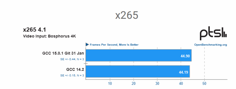

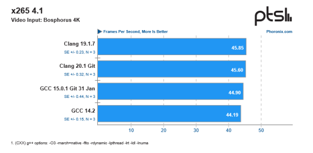

Checked out HandbrakeCLI 1.9 and it's built with GCC 13. GCC15 is the one that is unlocking extra performance with Zen 5 so gonna have to wait quite a bit for the next next Handbrake release before version 1.3.3 can be bid farewell.
Reactions: lightmanek
MS_AT
Jul 15, 2024
913
1,830
You know, you could just build it yourself with clang;)
When it comes to znver5 support in clang, it's just an alias on znver4, there are no zen5 specific tunings as AMD still has to add them. It's not like AMD's own AOCC is derived from clang or something...
GCC15 should indeed have Zen5 tunings based on measurements done by GCC devs.
I suck at Linux-fu and the official build instructions call for using GCC. Wouldn't know how to make the necessary changes to build with Clang. If you are not too busy, maybe you could help? :p
Win32-GUI version would be preferred but even HandbrakeCLI would be greatly appreciated!
It might be that there is already a fork on github that is publishing binaries built with clang. Also be aware that you might see no speed up, as the speed up might depend on multiple factors, including native os libs etc. For sure there are people publishing x265 windows binaries built with clang, but to my surprise it seems handbrake is compiling everything on its own so simple dll swap won't do.
I won't be able to look into that before April but if I am still around and you still care, you can ping me then. No promises;)

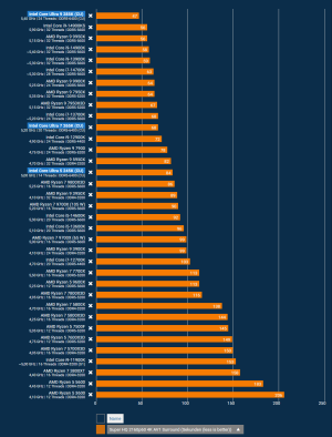

Looks good!
Though Zen 5 appears weaker in these German comparisons due to AMD not updating the stock speed to DDR5-6000.

My runs in comparison - same motherboard and bios version.
My PL1/Pl2 wattage is higher, but if I set the same as they did, the results were 49+s
My ram is 8600 while they are using 6400 CUDIMM.
P54 E46 MKV 47.39s
P51 E50 MKV 47.95s
P56 E50 MKV 48.1s

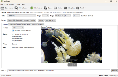

And do you know handbrake settings?
Reactions: Nothingness
ArrogantHair
Feb 6, 2025
49
38
51
I just went with what little they listed - Super HQ 2160p60 4K AV1 Surround, HEVC Surround, 30-Sekunden-Jellyfish-Clip (HEVC, 10-bit, 400 mpbs)
Edit - I just realized I messed up - will redo.
