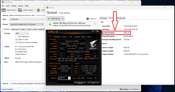

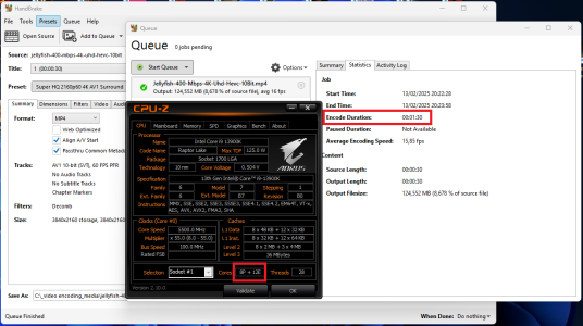

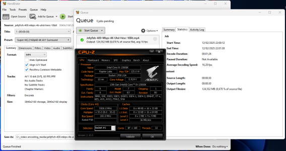

I know, I have a 13900K. But its not necessary to know how p or e cores work. Those differences between the three ARL are just a joke. Literally impossible. And probably the rest are just crap too.
For example, my 13900K encoding time is 1m26s (stock -Intel extreme profile enabled- and RAM @6000). 13900K review encoding time is 0m59s. Thats 46%!!!!!!! faster than my 13900K. No way if they really use "Super HQ 2160p60 4K AV1 Surround" preset as they state.
900 Frames / 16.28 fps = 55.28
Their chart shows 58. Your 13900k is performing better than stock.
So- yes way.
(also use output format MKV - as MP4 is slightly faster -- my scores are MKV - and yes, we dont know which they used but the difference is small )

900 Frames / 16.8 fps = 55.28
So- yes way.

<look at me point at encode duration, when I just showed you how it's calculated>
Frames / FramesPerSecond = Seconds

This is my 13900K @8P 12E (instead 8P/16E)
So with 16E is just ~5% faster than with 12E.
Now, our new CPU engineering expert will enlight to all of us how its possible a 285K (8P 16E) is 45% faster than a 265K (8P 12E)

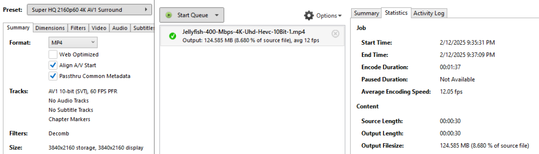

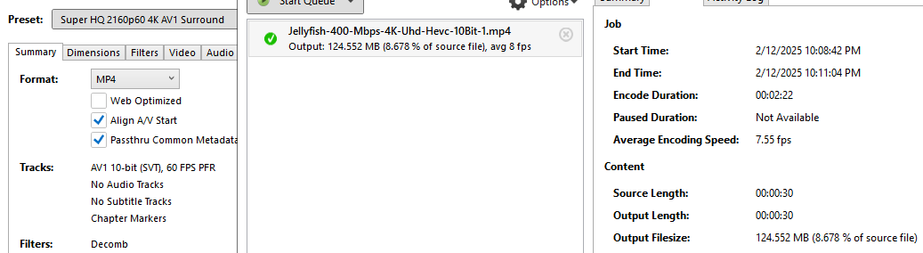

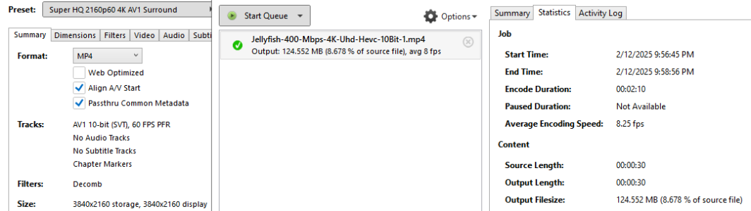

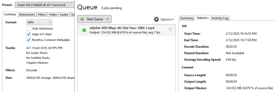

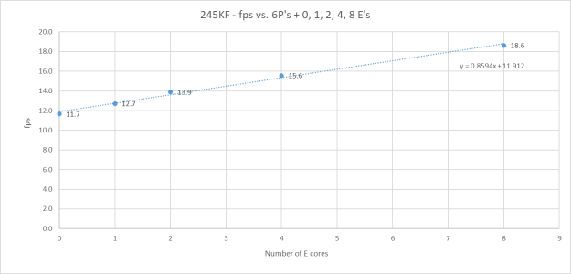

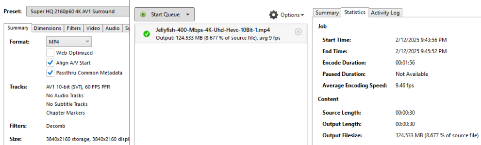

Jellyfish encode results:
245KF 6P+8E
6P+4E
6P+2E
6P+1E
6P+0E
Summary:
6P+8E - 97 secs
6P+4E - 116 secs
6P+2E - 130 secs
6P+1E - 142 secs
6P+0E - 155 secs
8E to 4E - 19.58% perf loss
4E to 2E - 12.06% perf loss
2E to 1E - 09.23% perf loss
8E perf loss - 59.79% (!!!)

The behavior is of course not linear and I expect it gets less linear as E's are added.
Would love someone to test 0, 4, 8, 12, 16E's with 8P's while holding all clocks constant for each run. 4.5GHz for P's and E's would be doable.
We could get a good look inside Handbrake to see how it handles additional threads.
I would graph the data if someone wanted to try it. It's 6 runs, but those clocks have to be locked down to a frequency that can be reliably held at the 8+16 configuration or else it'll be garbage in garbage out.

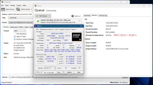

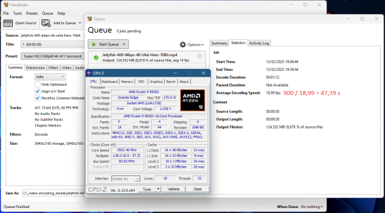

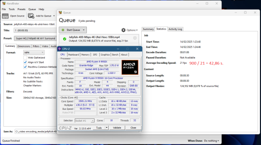

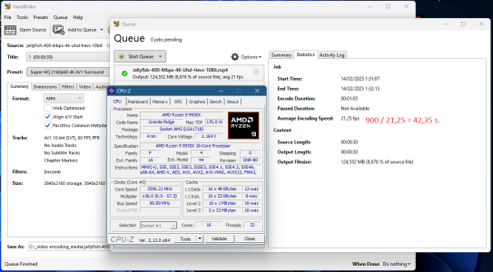

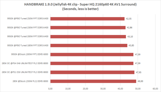

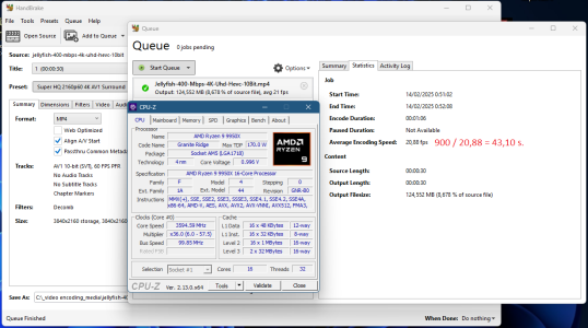

so I did some runs with my 9950X. These are the results according to your encoding calculation method:
Stock 200W PPT / DDR5 6000: 47,39 s
PBO Tuned 180W PPT / DDR5 6400: 43,85 s
PBO Tuned 200W PPT / DDR5 6400: 43,10 s
PBO Tuned 230W PPT / DDR5 6400: 42,86 s
PBO Tuned 250W PPT / DDR5 6400: 42,35 s
Summary (including your 285K results):
