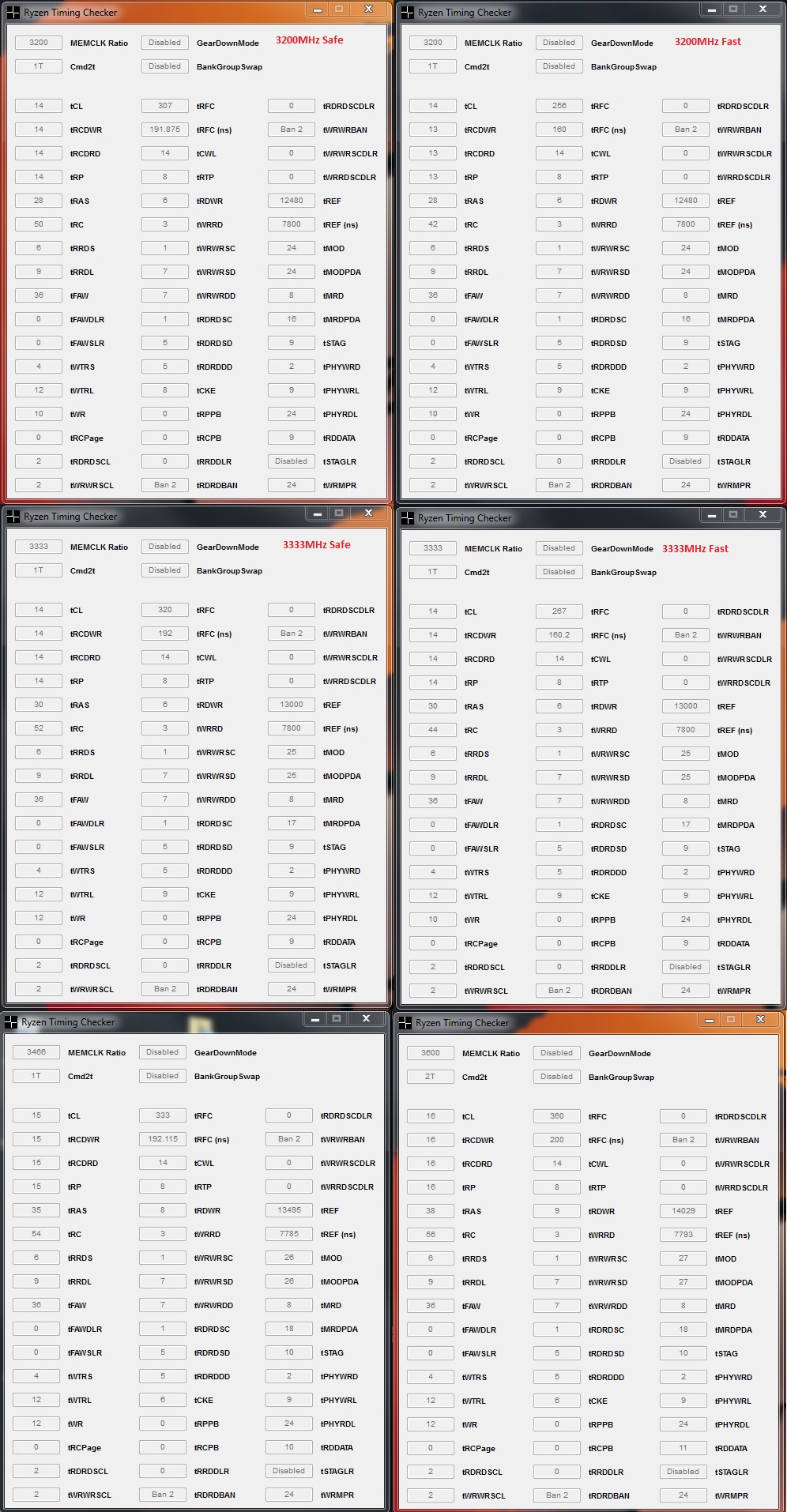

So on the B350 board, it topped out at 3600 - it wouldn't boot 3733. Not bad for a $60 mobo.
As for what is possible with 4x8GB (32GB total) of Samsung B-die (3200 CL14 binned), I installed the F21 UEFI (AGESA 1.0.0.0a for PinnaclePI) on the Gigabyte AX370 Gaming K7 Board. It boots at 3466 and 3400 CL14 with 4 DIMMs but will error out eventually on memory testing. The highest stable clock I've achieved out of the box (i.e. using 3200 CL14 XMP profile, then changing the speed) is 3333 CL14, all 4 DIMMs populated:
This is high-end memory with a high-end X370 board and a reasonable CPU sample (1800X). I plan to compare against X470 and Ryzen 2700X once I purchase those.
Not bad for 1 year out from launch.

Are you sure that your system is completely stable? Those number are really bad for that speed, I get better results with 3333 CL16
With 4 DIMMs populated?
It passed an overnight AIDA stress test on the memory. Maybe I'll try something else for verification.

See if you can get one of The Stilt's 3200-3333-3466MHz profiles stable, as these have proper secondary and tertiary timings. Don't leave these up to the motherboard since resulting performance is lackluster. These are to be used with at least 1.4v, stock 1.35v XMP isn't enough.
If 1T is hard to stabilize, then 1T+Geardown+even CL or 2T+no geardown should make things easier.
These will require more voltage to be stable vs only tight primaries, but the results are more than worth it:
This requires 1.425v on my particular kit.
1usmus over at OCN has dual rank sticks (similar load to 4 SR sticks), and he's been getting better and better results as AMD improves their AGESA code.
http://www.overclock.net/forum/11-a...vi-overclocking-thread-3448.html#post26972489
It seems he's stabilized 3333 14-14-14-28 with proper subtimings..... you'd usually only see stuff like this on single rank sticks.
