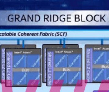

Sierra Forest should be pretty much the same SoC as Granite Rapids, just substituting a Redwood Cove core for a Crestmont (?) module. So yes, that looks to mean the mesh, though fewer die to die hops should help vs SPR.
Aren't they moving the IO part to a tile with SF?
So it'd be a 6x6 CPU tile with the 4 cores per spot. And then the IO tile.

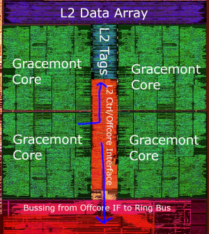

Do we know if Sierra Forest is still using the mesh interconnect? I'm curious to know whether they'll still use some type of E-core module or this was done solely to accommodate E-cores on the consumer ring bus.
It's the same dreaded Mesh Interconnect but made it worse because those 144 e cores will be divided into 36 quad clusters, and each quad cluster has its own dedicated ring bus interconnect.
Minus the memory controller + PHY, yes, the IO is moving to those endcap tiles. Possible they do a non-square arrangement though. Curious to see what it ends up as.
