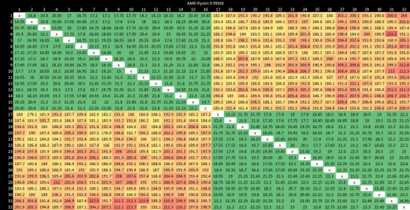

I'd also add there's little gain in thread-to-thread latency between sibling threads on the same core rather than threads on different physical cores. It used to be thrice as fast on Zen 4, but that's not the case anymore.
