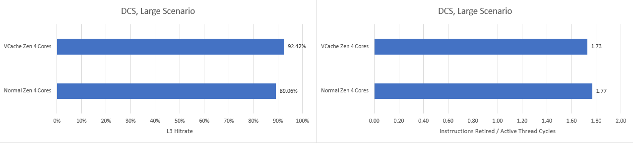

You can't defy physics, engineers aren't magicians. 1-hi V$ already has a 4 cycle penalty. When going from 32MB to 96MB, those 4 cycles are worth the hitrate surplus. When going from 96MB to 160MB, that surplus is smaller, which might render the additional hitrate pointless in a lot of scenarios due to additional latency.

Here's an example of lost throughput due to additional cycles of latency. Already present when going from 32 -> 96MB.
you don't actually know that for sure, and even if its 2 (or 8) more cycles, its still 3.9x less latency than hitting DRAM
Its literally not a debate that not all games get a benefit from more cache. hence why AMD moved the cache to the bottom die to offset the clock regressions.
What even was the actual difference in FPS/GPU load with that ratio of cache hitrate and IPC? Probably near 0. 1.73 to 1.77 might as well be nothing.
