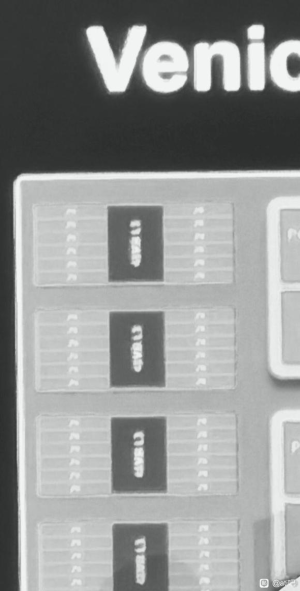

Looks like Venice and Medusa may share the same N2 12C CCD after all
So looks like 1 IOD may have 4 CCDs connected to it, 2 on each side, and 2 IODs are shown, which would be 8 CCDs x 12 cores = 96 cores?
Edit: Since Turin has 128 cores, 3 of the IO Dies could add up to 144 cores, which could be more likely for the core count.
But if there are to be 16 memory channels, then 2 or 4 IODs would make more sense.

Would be weird to go backwards on core count, but maybe they are just targeting maximum performance per core for regular Venice. 96 cores @ 6GHz @ 600W maybe? :p

Link didn't work for me, but I'll take your word for it :).
If that is the case, then:
  • Desktop is assured to be N2 CCD
  • Likely 192c for the high performance Turin
  • Turin D @ ~240-288 Zen 6c cores (20-24 CCD's)?
Here's the image from the Xitter post, which shows 12 core CCDs with 48 MB L3 cache. It also looks like there's multiple IODs on package.

Turin Classic
1 IOD = 4 CCD = 48 cores
2 IOD = 8 CCD = 96 cores
3 IOD = 12 CCD = 144 cores
4 IOD = 16 CCD = 192 cores
Turin Dense
Lets say they can get 25% more cores in the same die so 1 CCD = 16 cores (round up).
Max Turin Dense then is 256c
