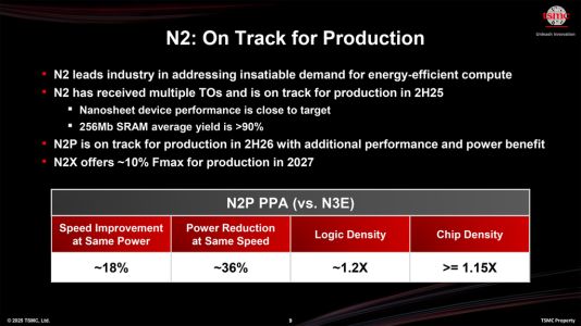

Turin D 16 core CCD is already on N3E. The shrink from N3E to N2 is 25%.
TSMC says otherwise also logic is 1.2X Chip Density is 1.15X.

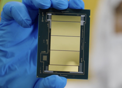

what's a 4 IOD and how do I escape route 16 memory channels outta datboi.
It seems that Intel has a good idea to position the IO Dies on the sides of the CPU rather than in the middle. But disadvantage of that is that there may be a need for some sort of mesh in the base die.
AMD has, so far, had a single connection from CPU chiplets to IOD, While IO Die is responsible for - well IO.
The idea posted by MLID is that this continues, but there could be multiple IODs, and only the IODs are linked. For that, central positioning of IODs (rather than edge as intel has it) is better.
But that does not answer the question of how you connect to all the IO, if IO Dies are centrally located.
It seems that a good sized RDL / base wafer could do the job...

There could be a silicone interposer under the IO Dies that runs the length of the 4. It can be narrower than the IODs to allow the shoreline connection from the CCDs and have sub-surface connections out to the socket contact pad through the substrate.
How would that ughhh work.
It's a Northbridge. It's responsible for literally everything.
They're just halves.
AMD does stupid simple designs and whatever overcomplication you're thinking of is just not real.
The way I understood MLID take on this that there would be a "module" with IOD and 2-4 CCDs. They could be connected using a (large) base wafer with RDL type connection.
Then these modules would connect to one another using a bridge of some kind. Presumably silicon bridge, possibly using hybrid bond for interconnect. (could be something else)
That was a leak from some time ago (year+) so who knows how related it is to reality. But given quickly we are approaching Venice release, AMD already has a solution in place, we just don't know what it is.
Not sure where I got the 25%; however, if your link is accurate, then it becomes even more unlikely that AMD would produce a 32c Zen 6c CCD.
