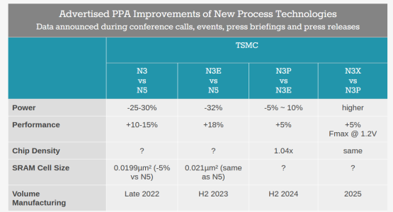

Why so many node variants? N3, N3B, N3E, N3P, N3X... 5+ node variants per node! don't they cost too much to create in the first place?
ask TSMC for this they are trying to create history by competing with Intel 14nm+++++.
Anyways N3 is Node family and N3B is the node no one wants to use you are left with N3E/P/X all are design rule compatible with just slightly different PnP characteristics.
