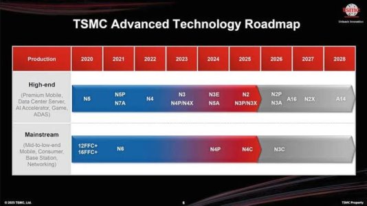

hmmm but the info is zen6 = n2x release in 2026
also I see N3C??? how is it economically viable to make so many new nodes per year

I see no business reason for AMD to pay for N2 if they can best Intel with N3P.
- At the time they had to decide on a process node, they couldn't know for sure whether they can best Intel with N3P or not.
- Wafer price mark-up of N2 vs. N3P is allegedly relatively modest and more or less worth the density and efficiency/clock gains, by the sound of it.
- By using N2, they could possibly best Intel by a larger margin than if they used N3P.
Intel still has some legacy clout left in both mainstream consumer space and the corporate world, AMD would have a better chance of continuing to win mindshare by consistently beating Intel by a healthy margin.
At the very least, the 32c CCD for Venice-D probably needed the density and efficiency gains of N2 anyway.

my take: Zen 6 - N2P, client announcements at computex, launch in July. Rebrand won’t happen. 11950X, 11900X, etc.
This is based on publically available data. Not a leak or from leaks/rumors.
EDIT: if not N2P, it will be a customized N2 process specific to AMD. (they have done this before)

511
Jul 12, 2024
5,563
4,967
My take Zen 6 is Vanilla N2 if it is N2P it is launching H2 27.
