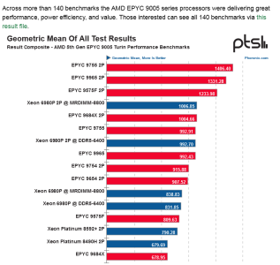

I mean GNR is already competitive with Turin standard iso power, according to AMD. Turin Dense has like a 25% lead.
At same power the regular 128C Zen 5 is almost 20% faster than a 128C Xeon, wich mean that it would consume 35% less at same perf, that s 50% perf/watt advantage at isoperf.
Beside 25% perf lead for Turin D at wich power.?.
At same throughput than the Xeon 128C@322W, and in Phoronix tests, it would be at about 190W since the perf gap is only 20% at stock for their tests suite and with 275W power at stock, that would push the perf/watt advantage at 70%@isoperf.
At same throughput than the Xeon 128C@322W, and in Phoronix tests, it would be at about 190W since the perf gap is only 20% at stock for their tests suite, that s a massive 70% perf/watt advantage at isoperf.

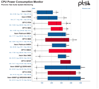

You are messing up the numbers 9755 was consuming 324W and 6980P was 331W also the performance difference was 20% and a 3% power advantage roughly translates to 23% PPW.
If it perform 20% better at same power it will perform the same at 0.65x the power, that s a given that you can trade much higher efficency for more perfs, the more you increase the perf the more you decrease efficency.
By the same token you ll have to increase the Xeon power by almost 50% to match the stock 128C Zen 5 perfs wise.
I see you used maths 🙂
These are just assumption without data cause the power performance curve is non linear.
All the benches are not perfectly parallel as well some benches favour Faster fewer cores(64 Core EPYC Winning some are memory bandwidth heavy )

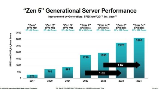

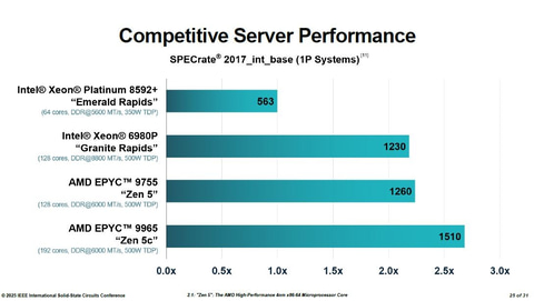

How is it that Z5 does here 1260 while pairing two 128C CPUs get you 1360 per CPU for a total of 2720, that would be overscaling, so isnt this slide erroneous with a typo.?
Edit : if two 128C do 1360/CPU in a 2P configuration i would imagine that a single 128C would do more than 1360 but certainly not 1260.
...maybe the end notes [9] and [11] could clue us in. Or maybe not, because such endnotes are never going into every last detail.
It could have been something as simple and arbitrary as the 2P system having better cooling than the 1P system. Besides, there is always some chip-to-chip variance.
compiler flags and OS and other stuff makes the result variable as well.
Could be, honestly, idk, but doesn't change much of my take away at least.
The Zen 5C configuration also had worse than linear scaling.
