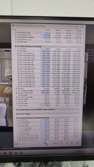

The HWinfo screenshot there shows 5.54 GHz peak of cores of the 3D V-Cache CCD and 5.71 GHz peak of cores of the vanilla CCD.
For reference, AMD specifies Ryzen 7 9800X3D's peak boost clock as 5.2 GHz and 7800X3D's as 5 GHz.
