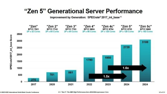

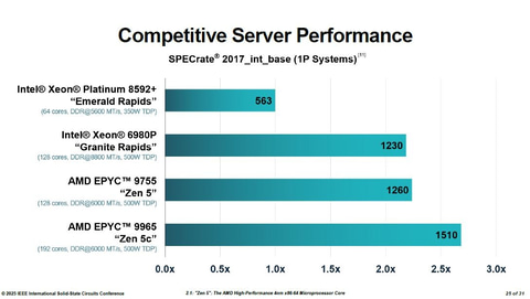

The Zen 5C configuration also had worse than linear scaling.
We re talking of the regular 128C, one CPU is supposed to do 1260 while two CPUs manage to do miraculously 1360 per CPU.
Beside if the 6980P was that close in Integer it wouldnt be that lagging in 7Zip, wich according to AT is quite representative of servers perfs in real world.
7Zip score are at the top of the page :
It could have been something as simple and arbitrary as the 2P system having better cooling than the 1P system. Besides, there is always some chip-to-chip variance.
Two CPUS in a box are unlikely to be better cooled than a single one in a box half the volume, say two 128C in a 4U rack and a single 128C in a 2U.
The volume is halved in the second case but the rack total surface is almost the same, so the second case has lower thermal resistance overall.
I'm saying the Zen 5C variant also exhibits that same trait. Each CPU is supposed to do 1510 while two CPUs manage to miraculously do 1550 per CPU.
It doesn't seem to be a typo, but due to the litany of potential reasons the other people have posted in this thread.
Pretty sure Zen 5 is ahead of GNR in a similar category of spec2017 of as 7zip.
Besides, the gap is like 20% there. That's not exactly a generational lead (other than maybe Zen 3).

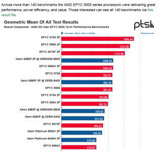

Aggregate scores are evil, see GB6 aggregate score for MP for instance. And Phoronix ones are even worse, mixing single thread and multi thread tests; are you even able to say how they come up with an aggregated score where for some subtests a lower score is better than a higher one?
GB multi-core scores suck because Primate Labs decided to make them suck.
Phoronix scores are awesome because when you take an enormous number of samples the central limit theorem kicks in and makes them awesome.
In defense of Phoronix, they do a better job with their server/workstation benchmarks than they do their desktop benchmarks. The selections seem more relevant (at least to me), and most (but not all) are aggressively multithreaded.
Nothingness
Jul 3, 2013
3,374
2,475
It's still hard to say in their selection what benefits from MT, what benefits from unrealistic parallelization, what is purely ST. OTOH having a large selection helps people looking at the workloads that matter to them; and that's why I was pleading against aggregated score.
Something similar applies to GB6, but at least there you clearly know what is supposedly ST or MT. And they don't mix results measured in seconds with results measured with scores. Phoronix aggregated score remains a mystery to me (I quickly searched for that information and couldn't find it).
Reactions: yuri69 and MS_AT
Problems with GB6 are that is more for desktops, not for servers. Also, Phoronics does not count much for avx-512, it does little benchmarks for that, but in servers it is important.
Since the average difference is 20% and that ST differences are quite lower one can
deduct that average MT difference is higher than 20% to get the ST + MT geomean at 20%.
Well, they do definitely more tests with avx512 enabled software than they do compile tests, not to mention they often have specific avx512 comparison articles, while they completely ignore throughput related nature of compilation workloads for CI/CD servers which is usually the role of 64 core+ servers.
Reactions: lightmanek
Nothingness
Jul 3, 2013
3,374
2,475
They made 2 reviews with AVX-512 for Turin:
Too bad we don't have results for competing Intel chips in the same runs, but I guess these can be extracted from their DB.
I've just flagged this post as trolling.
Let's do a breakdown of the benchmarks included in https://www.phoronix.com/review/amd-epyc-9965-9755-benchmarks/14.
They got 11 pages of benchmarks. I've *quickly* glanced over them:
2) OpenSSL uses AVX512
3) John the Ripper uses AVX512; RockDB aka Databases most probably uses AVX512
4) HPC nearly every single one uses AVX512
5) see 4)
6) OpenFOAM uses AVX512
7) OSPRay uses AVX512
8) Embree uses AVX512 heavily, OpenVKL uses AVX512
9) NumPy uses AVX512, 7zip uses AVX512
10) uvg266 uses AVX512, SVT-AV1 uses AVX512
11) libavif most probably uses AVX512; GraphicsMagick most proabably uses AVX512
12) OpenVINO uses AVX512 heavily, there are binaries of Tensorflow wich uses AVX512 - dunno if Phoronix uses that one
13) xmrig uses AVX512; Stockfish uses AVX512

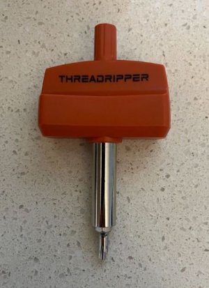

Yeah a cousin was building the 5000 series threadripper and noticed memory issues.
I thought it was ram voltage, and went though almost 3 hours of debugging before i decided to hit Google.
Realized if the CPU is not Torq'd properly, the contact can be uneven, sometimes causing memory errors.
I then asked did you use the special AMD tool?
He was like what AMD tool?
Then i showed him this picture:
Because i remember when i built my EPYC a while back, i had to wait for that tool to come in to finish the build.
He then looked at me and went... AMD has a special tool?
I then went YES... u want HEDT? HEDT requires special tools.
I brought my tool over, properly torqued everything down, and poof.. all the errors disappeared.
Which is why i started that rant... i just finished building 3 AMD systems this week.
A 9800X3d. 9700X and a 9600X. And i was annoyed as hell having to remove those plastic clips in EVERY board, and saving them incase i ever needed to do a RMA, because i can bet you Gigabyte / ASUS will straight up deny the RMA if you do not reinstall those plastic stupid clips.

I don't understand where the issue is, AMD ships every Threadripper CPU with a dedicated tool, and if you somehow throw it away before installing CPU, 3 seconds search on internet turns out correct torque spec. which is 1.5Nm. Use any torque wrench you want and set it to 1.5Nm.
I've build 4 TR setups myself and took my own CPU about 10 times out of the socket to change cooler or for maintenance. If you follow instructions telling you in which order to fasten screws, you will not have any problems.
Markfw
May 16, 2002
27,406
16,255
I don't know how that converts, but I saw 13-15 inch pounds. If that the same, I apologize.
aigomorla
Sep 28, 2005
21,131
3,667
A lot of the threadrippers are sold second hand as a combo, or used at a heavy discount.
The original seller does not include a tool sometimes. If you buy any used threadripper im sure you will not get the tool 100%. He got his as a combo used, and wanted to check for pin damage on the motherboard like i always taught him. He was not aware of the rules of threadripper and the proper installation of one, thinking they were like his many intel CPU's he has had before.
ThreadRipper and EPYC are the only 2 cpu's i know which require a special torque because the cpu is just so big. Its a massive colossal die, and not many people realize memory errors can happen from a improperly mounted cpu.
Lastly i have a Torque screw driver. A digital one and a spring one. They were not cheap.
Not many people i can think of who even participated in this thread would have those specialized torque drivers, unless were talking about power tool, and you can't really set or dial those down like the drivers i have that were expensive.
I use them more for my water blocks to make sure they are all properly torqued and not over torqued so the compression around the Oring is perfect. If i wasn't such a hardcore water cooling fanatic, i probably would of never bought one.
