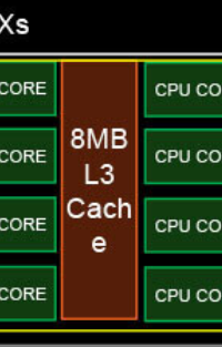

It looks like a very competitive chips for mainstream market, for laptops less expensive than Strix Point and Lunar Lake.
Performance should be quite close to Strix Point in most typical ST centric applications, and it looks like all 8 cores are on the same ring with 16MB L3, which would improve performance when running on 5c cores (due to larger L3) and cost of switching to full cores should be less. So overall power efficiency vs. Strix Point should go up.
Also, cheapest to manufacture (vs. Strix Point and Lunar Lake).
Josh128
Oct 14, 2022
1,505
2,256

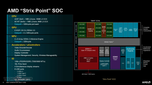

Where do you deduce this from? I agree, it would help perf, but up until this point it didnt look that way. I still think either 4C CCX +4C CCX will be more likely. Thats what the Geekbench shows. L3 would not be unified between the two CCXs.
Reactions: SteinFG and bearmoo
Joe NYC
Jun 26, 2021
4,011
5,559
Just a speculation, based on the fact that AMD can do ring bus with 8 stops.
It would be wasteful if if Kraken had 4x Zen 5c with a separate L3 and it would suck if the Zen 5c cores had no L3. So just connecting some dots (which may turn out to be wrong).
Joe, this is AMD we are talking about, AND presumably their lowest profit SKU. They likely just took the Strix design and neutered the Zen 5C 8 core cluster down to 4, cut the GPU down, and otherwise retained the exact same design to save time and money.

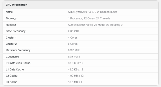

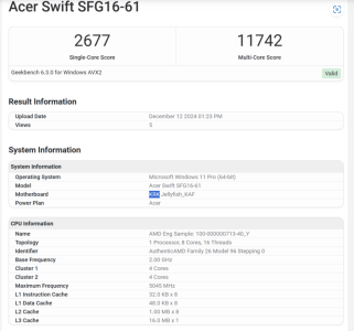

Yes, but it shows two "Clusters", which is accurate. I'd be willing to bet Krakan's cluster setup is the same. High latency coms between cores from differing clusters, just like Strix.
Geekbench reads that different cores are in different clusters, even if technically they are in the same cluster.

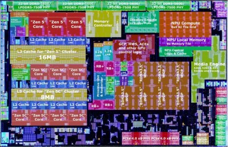

Strix Point dieshot from Nemez (GPUsAreMagic)
Strix PointKraken Point
CPU4 × Zen5
16 MB L3
8 × Zen5C
8 MB L3
59 mm²
4 × Zen5
4 × Zen5C
16 MB L3
40 mm²
GPURDNA3.5
8 WGP
41 mm²
RDNA3.5
4 WGP
21 mm²
SoC232 mm²~190 mm²
*Leaked info
**Estimates
***Measured
