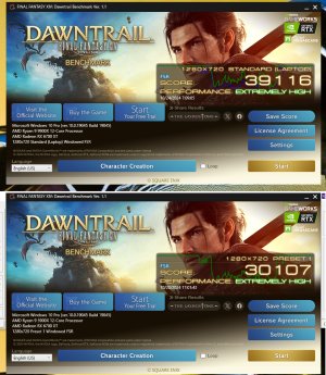

Good evening folks.
My 9800X3D Dawntrail result. 1.4v+, 5.86Ghz, AIO cooling + liquid Metal.
Bruh. World record?? Be very careful with that 1.4V mate, Anyway, whats the secret to reducing CL? My Teamgroup 6000 30-36-36-76 wont even post if I try to go CL28 without touching anything else from EXPO settings. Does increased RAM voltage help with lower CL? I know it helps with upping freq. Im not looking to break any records, just trying to pick low hanging fruit.
Reactions: lightmanek
28,174
19,218
Don't use EXPO. Switch to manual timings and only enter 6000 for speed and 28 for CL and let everything else remain on AUTO. Then the mobo should try to train the memory at that latency. If it fails, then you need to reduce speed to 5800 or even 5600. For a kit that can do CL28 at 6000, it should be rated for 6600 or 6800.

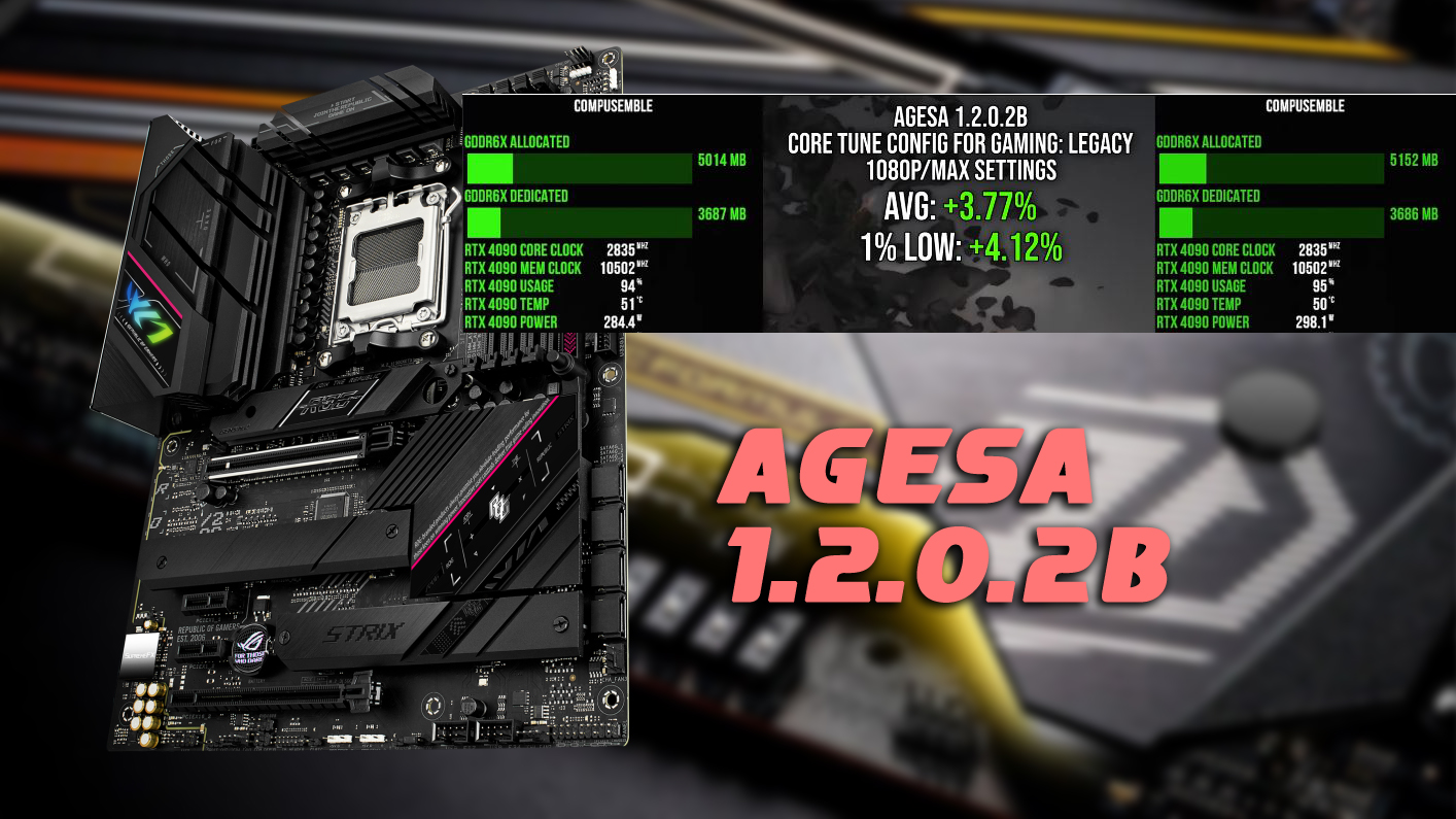

New AGESA 1.2.0.2.b out that supposedly reduces AIDA64 mem latency figure. WCCFTECH cites a website that tested and supposedly it helps gaming up to 5% or 6% as well. Anybody get a chance to test it out yet? I havent upgraded yet. I hate messing with BIOS when I have a smooth running system.
28,174
19,218
I've read the opposite. It increases the latency because the way AIDA64 calculates the latency doesn't take into account the change they made. Performance in games may be better. If you don't like the change, the BIOS will have a legacy option which resets the behavior back to launch one, according to AMD but they can only provide guidance to their partners. It's up to the mobo maker to decide what to name that option.
Josh128
Oct 14, 2022
1,541
2,291
According to WCCFTECH, its the previous 1.2.0.2a patch that increased the way AIDA64 reads it. In any case, their cited source claims BOTH faster gaming AND reduced reported latency in AIDA64. 🤷‍♂️
As mentioned in the results, this was achieved via BIOS 3065 Beta, which isn't yet official. Currently, you can only download the BIOS 3057 for this particular model, which comes with the AGESA 1.2.0.2a patch. However, the latest one should come out in a few days. One more thing to point out here is that the 1.2.0.2b patch shows improved memory latency as tested by the user in AIDA64 Extreme. As mentioned in the intro, the memory latency decreased to 64 ns from over 68 ns. This is similar to pre-AGESA 1.2.0.2a patch latency.
