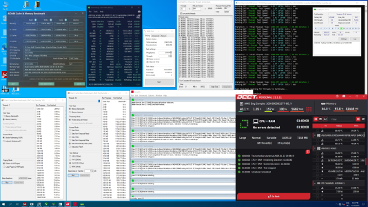

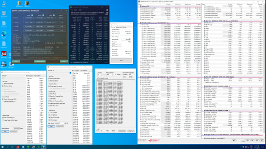

My 8400 a-die profile have reached its final form in the meantime 💪
Cpu cant run higher memoryspeed with a-die GDM disable, and memory cant run tigher timings, so i'm pretty much "done" on this combo.
Decided to complete all stability tests in a single boot to show that i dont cherry pick settings for spesific benchmarks 🤝
Manged to average 373mb/s over a 10 hour karhu run
Following completed:
  • 10 hours karhu @ 373 mb/s
  • ~350% runmemtestpro @ 36.5k mb/s
  • 1 hour y-cruncher all tests enabled
  • 1 hour OCCT large AVX512
  • 1 hour Prime95 large FFT's AVX512
  • Quick Testmem5 1usumus cfg to end it off

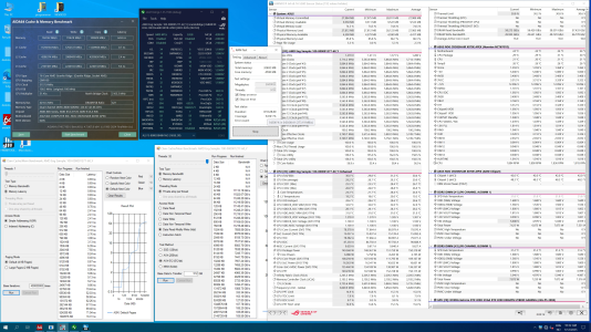

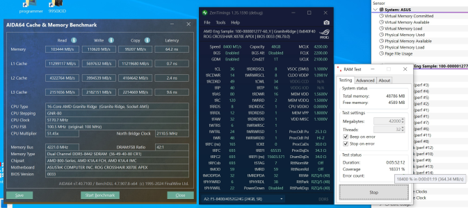

Have also had a few days to play with my 2x24GB m-die :)
Shouldn't come as a surprise for anyone i hope, but a-die fully maxed out is alittle faster than maxed m-die, but infact the difference was alittle less than what i originally expected.
End result was around ~373mb/s for A-die and ~364mb/s for M-die in karhu, while latency was also a tiny bit worse for M-die. (same cpu that caps out at 8400MT/s used for both kits) The main performance-difference comes down to the inability to run GDM disable with m-die at high memory-speeds
If the small performance increase is worth 50% less memory is up to you to decide i guess 🤔
Onwards to some screenshots (y)

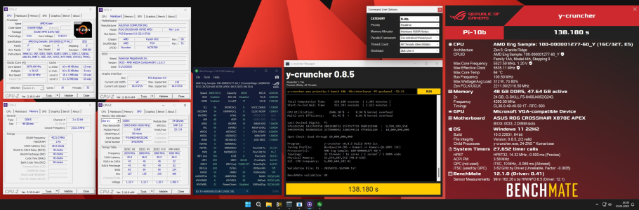

Managed 364mb/s average over 6 hours in karhu
Afterwards i also ran some ~9 hours runmemtestpro while i went to work
Also updated Y-cruncher 10B for hwbot before i went back to daily sticks

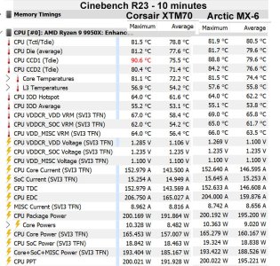

So I took Igor's advice and tried the XTM70 thermal paste. Here's how the test went.
Set TDP at 200W. Should have set it higher but I'm not doing it again!
MX-6 was applied as pea size in the middle of the spreader. When I took it apart the paste was pretty much perfect.
For the XTM70 I followed the Corsair instructions making the grid on the AIO plate.
10 minutes of CB R23.
Scores were the same within statistical variation due to same 200W limit. 40,010 for MX-6, 40,165 for XTM70.
I'm curious as to how people here would interpret these results?

I would say that in general, thermal paste is overrated. What I mean by that is any paste from a recognized authority (Corsair, thermalright, etc...) are all the same. I am sure there are exceptions.

I think try that again with the new paste?
You were right Igor. Compared to the MX-6 at 175W, with the XTM70 I'm able to run 185W at around the same or lower temps. Seems like the higher the thermal load the more of a difference between the paste brands. CPU(TctlTdie) average MX-6 175W is 85.3C vs XTM70 at 200W at 85.0C. Same temp but dissipating an additional 10W. I'm set to 200W TDP as opposed to 175W with the MX-6 but the render is only pulling 182W average, where before it was pulling 172W average. Now I'm fully utilizing the stock 200W cap on the CPU. Average clock 110MHz faster.
This CPU game is one of inches sometimes.
I'll take it. Thanks for the recommendation!
I agree. It's definitely "fooling around at the edges" kind of stuff.
It's hard to even tell if a degree or two is statistical variation during testing or due to application differences.
But I would rate the XTM70 as definitely as good and "probably" a little more effective than the MX-6 if I were comparing the two.
Yeah, I know, not a strong recommendation, especially for the price!

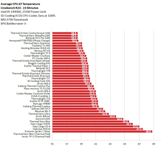

If you want to use a graphical representation to visually show differences between some values, then you must start from zero on the relevant axis.
Otherwise, the visual representation is very extremely misleading.
Not to mention that comparing temperature values is problematic.
Thunder 57
Aug 19, 2007
4,295
7,102
Yup. It's going to be twice as cold tomorrow. What does that mean? Unless using Kelvin, nothing.
Good point "0" is about 6 miles to the left on that chart.

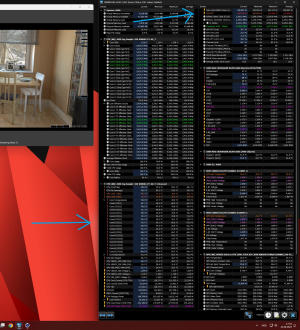

It helps if you got the correct setup to use the extra headroom
Temp-spread while running Cinebench R23 MT PBO daily tune
(GPU showing idle temp)
Keeping those die temps<80C while dissipating 300W is impressive.
If you have the time can you let me know what your cooling setup is and how hard it was to delid?
