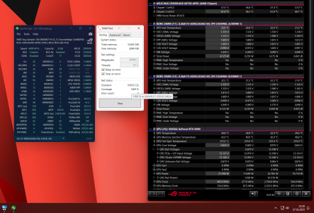

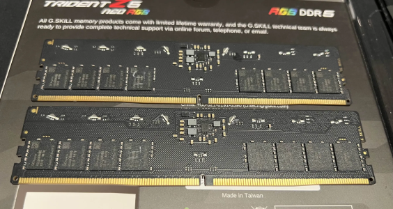

Have received my new G.SKILL 2x16GB 6000 CL26 EXPO memory set
First thing i did was to check how low i could go with VDD voltage while still running stock EXPO primary timings, to check how much "headroom" i had against stock settings..
Kinda seems like the sticks ive gotten of this binned SKU is especially superbinned 🤣
Only require 1.34 VDD for a quick karhu run @ 6000 CL26 :cool:

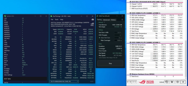

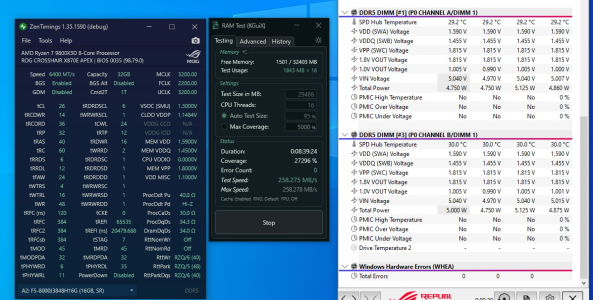

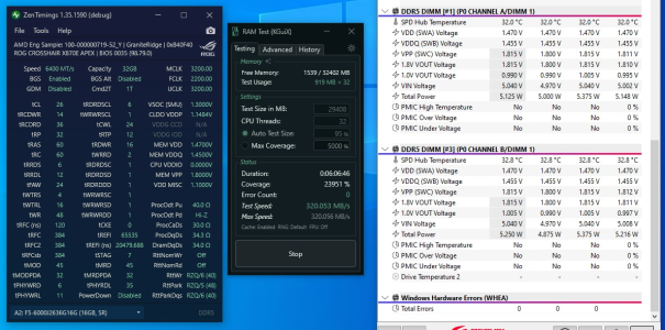

Have completed my initial minimum VDD requirement for 6400MT/s CL26 testing on about half of my memory, so will share my preliminary results as promisted :)
The following memory sticks have put to the test:
Trident Z5 Neo RGB DDR5-6000 CL26-36-36-96 1.40V @ custom heatsinks (new generation PCB*)
Trident Z5 Royal Neo DDR5-8000 CL38-48-48-128 1.45V @ custom heatsinks
Trident Z5 Neo RGB DDR5-8000 CL38-48-48-128 1.45V
Lexar ares gen2 6000 CL26 @ 1.45v (new generation PCB)
My interest was mainly to discover how tightly these sets were binned, and if there was a large difference between the SKUs
I picked the 6400MT/s memory speed at tightish timings since i view this a middle of the road approach which all A-die should be able to run, and other overclockers also can use this as a comparison for their sticks if they wish to. Please note tCL is the main timing that can be forced with VDD, and will also be the limiting factor when voltage limited/constrained. Stress-test of choice was karhu which i started when i went to bed for the night or work in the morning, so target runtime was around 6-9 hours.
Should also be said that i'm fully aware this is only a sample size of 1 per SKU, so it dont mean too much, but i have to work with what i have :p
Half of the memory have been run on the ASUS APEX while for the other half on my livingroom media-computer running a ASUS GENE+2233FCK 9800X3D sample .
But at this lowish memoryspeed motherboard should not really matter, as long as the cpu is is capable and the motherboard is not total junk.
(and 3 different cpus were used for this, but the only metric i'm looking at here is VDD+stability at given mem settings)
That's enough talking, over to some data :)
My new G.SKILL 6000 CL26 seems to be out of this world and managed to run these settings at only 1.47 VDD which i have to say i find really impressiv, these new sticks really are the next generation.
Next up we have the Royal Neo 8000 CL38 which used to be my "primary memory" before. It needed 1.590 VDD to keep stability
My regular Trident 8000 CL38 fared the worst of the bunch and needed 1.64 VDD
And lastly we have the Lexar 6000 CL26 which also did pretty good, coming in at 1.56 VDD.
One strange thing about this printer memory is that it absolutely hate to run 2:1 mode on the GENE/ASUS, even at very slow timings and 8000MT/s speeds, which all the other memory kits above ran with ease
. System was acting totally loco and was very unstable with the lexar memory installed running 2:1 mode while in 1:1 mode it was totally fine.
When Chew was active he found kinda the same, Lexar was a good match with a Gigabyte Tachyon motherboard and a bad match for ASUS GENE motherboard. No idea what's the cause of this, only rreporting my experience ..
So can only recommed this memory if you plan to run 1:1 mode on ASUS motherboard, good thing is that is pretty cheap compared to the rest.

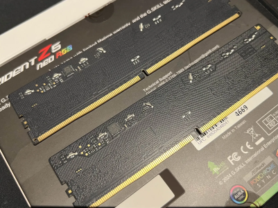

* = the new 6000 CL26 PCB (Credit goes to invictus for taking nice photos, first thing i did was drown mine in painthinner and installing the new heatspreaders, without taking any pictures)

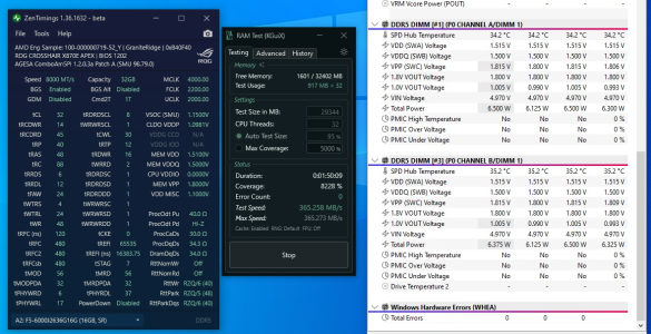

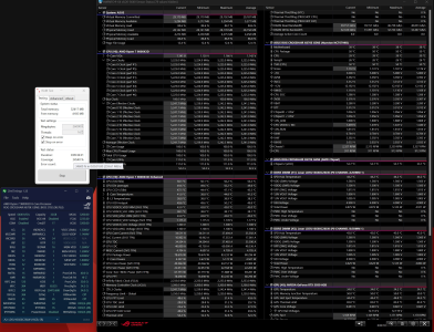

And lastly 8000MT/s with tight timings :innocent:
This new G.SKILL 6000 CL26 set runs 8000MT/S CL30 at the same voltage my old memory-kit needed for CL32 pretty much..
For 8000MT/s CL30 only 1.71 VDD was required, which i would say is fully daily'able, especially with the custom heatsinks only reaching ~38 degrees on the memory
367.7mb/s in karhu for this memoryspeed i believe is a new "highscore" for me
Settings is not fully minimized/maxed out either.. tRCDWR, tRC and tRFC can probably go lower, but i dont want to spend too much time working on the 8000MT/s strap.
Have moved on to 8300-8400MT/s and working on a profile there now.

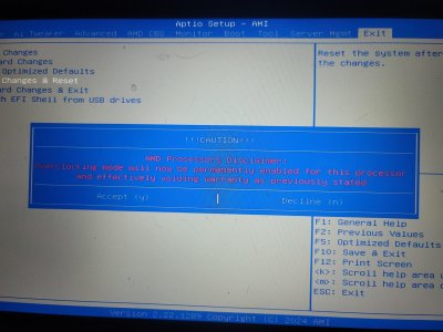

Guys Confirmed ThreadRippers all have internal fuses now which trigger even on activation of EXPO.
There is still a confusion on what part of your warrenty remains tho, as AMD says it doesn't invalidate all warrenty, only those associated with overclocking the CPU itself, but you will blow that fuse even if you activate only EXPO.
This is a sad sad moment for us overclockers.
I feel you guys on normal Ryzen's or the Ryzen 9 will get these fuses as well soon.

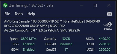

How about some runs at synced golden rule 8800MT/s 2200mhz FCLK instead

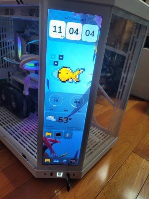

So my brother is like.. can you build me something better then RGB...
Oh boy... you guys are gonna roll on the floor when you see this. I actually 1 up'd RGB... Hyte Y70 Touch Infinite, and the Thermalaright warframe with LCD's. Yep... pictures come tomorrow.
Excuse me while i dig my own grave...
But this is the completed 9800X3D.
Need to do some wire management, but im waiting for his videocard.

It would be a killer build with killer female assassins instead of goldfish.
Maybe the Kill Bill Build? :p
im actually gonna troll him and put a Loli Kami gif later on.
The thing takes mp4, as backgrounds as well, so you can have that.
But the case is honestly fun... it really came down to either this or the snowblind case.
But i think the Hyte is more reasonable vs the snowblind.
This is snowblind btw:
And here is the actual case:
