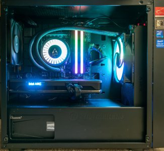

It's finished... for now. The Arctic Liquid Freezer III keeps temps at 81 max, 79 average when running CB R24 or R24 at 200W package power. Also, it's about 7 or 8 degrees better than my Assassin air cooler and much quieter across the thermal spectrum. Since it has more thermal mass the fans don't spike up and down every time there is a "bursty" need for compute. It was tricky getting the AIO in there. There wasn't room for the lower fan on the inside part of the case due to the opening for the power supply not being quite big enough. It will fit normal size radiators but the Liquid Freezers are deeper than most AIO's. I had to put one outside under the grill and the other inside. Top pull and bottom push so the radiator is getting external air. That's just about all I can fit in this case but I am thinking of adding a top 120mm fan and eventually a stronger GPU.

This is why I'm using a mATX case. It just fits too nicely under my desk.

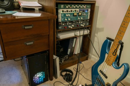

It's finished... for now. The Arctic Liquid Freezer III keeps temps at 81 max, 79 average when running CB R24 or R24 at 200W package power. Also, it's much cooler than my Assassin air cooler. Since it has more thermal mass the fans don't spike up and down every time there is a "bursty" need for compute. It was tricky getting the AI in there. There wasn't room for the lower fan on the inside part of the case due to the opening for the power supply not being quite big enough. It will fit normal size radiators but the Liquid Freezers are deeper than most AIO's. I had to put one outside under the grill and the other inside. Top pull and bottom push so the radiator is getting external air. That's just about all I can fit in this case but I am thinking of adding a top 120mm fan and eventually a stronger GPU.
I'm probably the only one around here that's more jealous of the audio rack than the PC upgrade. How's the Warm Audio API clone hold up against the Vintech and Daking pres? Are those the "T" versions of the Comp II/ Pre II? Love the mix of Trident, Neve, and API type preamps. I've lusted over a setup like that forevever but could never justify the expense since I only do music as a hobby these days.

Good catch on seeing I was going for a variety of mic pre tones. Neve, API, and Trident. You obviously know your gear. I really like all of them. . The Daking is the all-arounder. It's really good on everything. The Warm Audio is my favorite for bass and drums. It's thick and punchy. Vintech for vocals generally, it's nice to have the hi/low eq outboard to commit that high end "air" that you generally add later anyway. Plugs are really good these days but there is still a special something to good outboard. Honestly, as you know every singer/instrument and mic combination is different so I'm still trying various combinations of pre's and mics. I was a pro for many years, had a studio in the '90's mainly for my band but also recorded others. Now it's more of a hobby so I pared the gear down to basically this rack. It's a relatively small amount of gear but still provides choices when I do have a more serious project.
That's a sick setup. I bet it sounds killer.
I remember back in the day (when I was still trying to make music for a living) I'd put all the gear I was lusting after (that I was too broke to afford) into a cart to see how much my dream setup would cost me. That cart pretty much always had a Daking Mic Pre 4, an API 3124, and 4 channels of Neve clones in it.
I never really did recording/live sound more than semi-professionally and it's really just been a hobby for the last decade. I did get to use all of the nice analog gear when I was in school though. I also had a few chances to do sessions at some word class studios with a bunch of incredible vintage gear. i love nice gear but I always got by doing most of my projects on much more modest stuff at home. Top shelf analog outboard and mics are obviously awesome, but the cheaper stuff has come a long way these days. I seem to have acquired a lot more nice drums, cymbals, guitars, amps, and pedals over the years than recording gear for some reason. I'm a bit obsessed with guitar tone, and I even got into building tube guitar amps for a while, so it kind of checks out. Seeing that I'm a probably a better engineer than drummer/guitar player, I should probably pair some of that stuff down and put together a new tracking setup. I'm just recently getting back into recording and mixing more often. I haven't done a project since before COVID.
You're not kidding about the plugins being really good. i grabbed the UAD signature bundle for $300 recently and I've been remixing some old projects on my 7900X rig. I'm pretty impressed with how good this stuff sounds. I mostly just used stock and free 3rd party plugins for years. I'm still using Pro Tools 2018 and it seems to be working fine for me so I'm not sure if I'm going to renew my perpetual license anytime soon. Avid can pound sand with their subscription. I really don't want to use another DAW after working in PT for 25 years though.
Anyway, sorry for the ramble and veering way off topic here. I imagine that 9950X is killing it in Studio 1. I can barely get my 7900X to 15% CPU usage with a Pro Tools session loaded with plug-ins and a 64 sample buffer. I'm not running a bunch of VI's though. I've been following your Intel saga around here and I'm glad to see you finally made the move over to AMD. That rig should hopefully be way more reliable for you. Congrats on the upgrade. :beercheers:

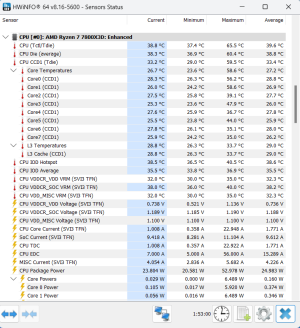

Anyone's 9800X3D seem a bit toasty? My intel 9600k was like 36c at idle. My 9800 is sitting at 47-50 ish idle. It was doing 60c which definitely seemed too hot at idel, but I replaced corsair's garbage AM4/5 bracket that has the loops and just two thumb screws on the water block in favor of their new one that that uses 4 screws for even pressure. I guess it doesn't matter much when my corsair 150i elite 360mm cooler can keep it at 85c under full load in cinebench 2024 with the fans barely hitting 900rpm.
Something to do with the GPU driver and some power setting maybe.
It definitely isn't the power setting as I have it set to never sleep or hibernate or turn off displays. The AMD drivers are also fresh on a brand new machine.
It's normal, mine is the same. The 7800X3D was like this too. The idle power usage is a bit high on this platform in general. Load temps are 70-75C on air cooling.
Reactions: Sonikku
Win2012R2
Dec 5, 2024
1,327
1,367
My 7800X3D (well 7950X3D with one chiplet turned off) 55C idle, power 40W (as reported by Core Temps), memory is EXPO 6400.
Seems ok temps, it's silicon not tap water...
Reactions: Tlh97 and Sonikku
These are my idle 7800X3D temps now, running EXPO 6000 and 1.2V SOC voltage, otherwise stock. In the summer (without AC) they're in the low 40s. My cooler is a Thermalright Phantom Spirit 120 SE inside a small form factor case, the NR200. I'm curious what temps I'd get with a 9800X3D.
And my thermal paste application method FWIW:
Reactions: lightmanek
