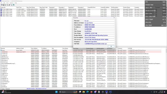

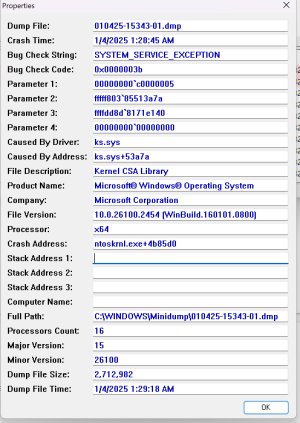

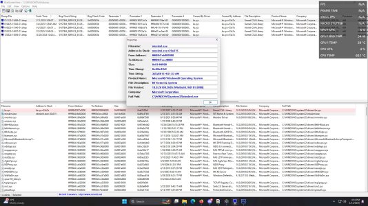

Use BlueScreenView and open the dump C:\WINDOWS\Minidump\010425-15343-01.dmp if it still exists.
It should have a stack trace pointing to a module/driver which "caused" the crash.
Thank you for the link here's what it found.

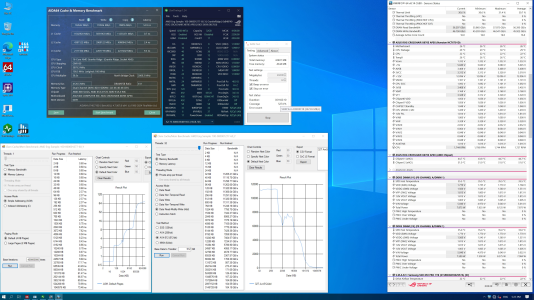

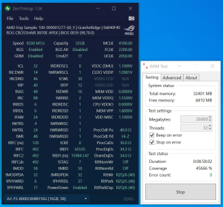

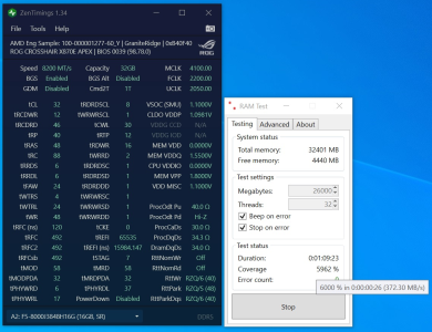

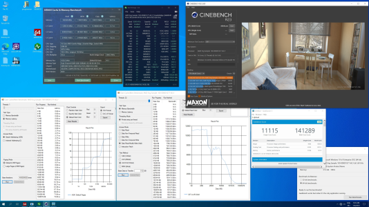

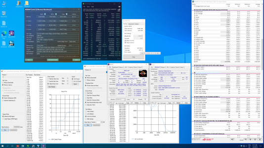

K i'm back from my little time away from this forum (have been crazy busy testing new stuff lately)
K its time to show what i have been cooking up lately and the reason why ive been so quiet

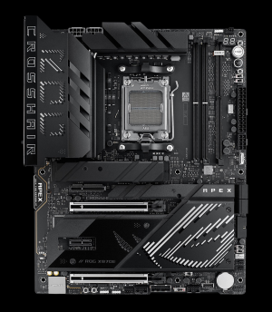

I had the lucky opportunity to test the ROG CROSSHAIR X870E APEX a few days before announcement, so i thought i could share my own preliminary results here, but do note this is very far from finalized results :)
Hardware used for my short tests:
Delidded 9950X ES running PBO
2x16GB G.Skill Trident Z5 Royal Neo A-DIE @ daily 1.76 VDD / 1.55 VDDQ voltages
Very large custom cooling with mora
First off we have some short karhu run, only 1 hour durations do to time constraints.
Core Tuning @ level 2 = over 10mb/s higher throughput then anything i managed on the GENE, ended at a wooping 372.3mb/s :cool:
With everything open bandwidth drops alittle, but still much higher than anything else :sweatsmile:
Also did alittle test in GB3 on the same boot which netted me a wooping 15.2k / 14.75k memory score which is very good for a 9950X i would say
To top it all off, a baby 49k in Cinebench R23 MT while still running PBO ;)
I also did a short 1 hour karhu run @ Core Tuning = legacy -> 53.9ns in AIDA64
Do note its pretty much only in AIDA the latency drops close to 10ns, while Clam latency stays the ~same
All in all i can say from my short test that this board have sick memory performance/effiency, and VDD ceiling seems much better than other boards running agesa 1.2.0.2B
(started a run while i went to work earlier today)
Would recommed if your looking for a memory tweaking board :innocent:

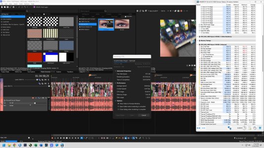

Absolutely hammering the 9950X right now with a 90 minute Vegas Pro encode using Voukoder to x265, slow setting.
I have the power limit set to 175 Watts because this application hits the cores harder than anything I do in terms of temps.
The die temps seem a little high but the cores seem to only average about 64C.
Anything to worry about here?
These temperatures seems to fluctuate a lot more than my Raptors did. Also the tile temp is so much higher than the core temp?
Am I good at 175W you think or should I back it down a bit?

I think 200 is the default. When I do all cores on heavy avx-512 I fot 80c (stock) so 64c is cool.
No worries in your case.

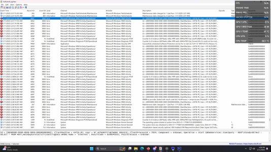

I don't see anything. But maybe it wasn't the issue after all. I had another blue screen...
So many errors... hm. This machine is cursed.

28,175
19,192
Use the PC for a day or two with just one stick and then again with the other as the sole stick. If the errors happen only with one stick and not the other, that's your issue.

Does the CEC interface show up anywhere in Windows' device manager?
You looked through all device categories, not just video related ones, right?
In the first screenshot of your three attachments, Ethernet is referenced in the event line which you selected. How about the other lines (records 6062…6095) of the same error event; are they all about networking or also about other subsystems?
And right before that, there are log lines from Task Scheduler. Maybe some background routines (which might also be started after you switched the screen off) are triggering the crashes?
PS, I don't know Windows very well. Besides various Linux PCs I only have an old rarely used Win 7 laptop at home, and I don't administer the Win 10 Dell PC at my workplace myself.

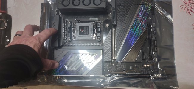

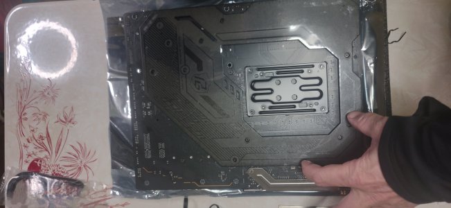

So started assembling board ect.
Need encouragement.
Remove and repad VRM and backplate VRM pads? I went with Barrow air cooling for RAM.
Also if you remount and or repasted a lot these are really awesome to use.
The isopropyl is 99%. It's for fiber optic cleaning. Just be careful not to scrub too hard.
Great information, thanks for sharing.
For that CB 49,000 run, what is your voltage under load? Package power? Frequency? Temps? That's a big CB number!
