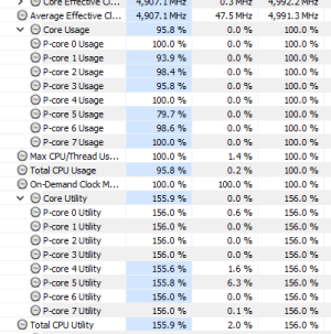

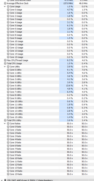

OK, a problem with my first B650 board. Running BOINC, and 2 8 thread tasks (no smt) its only taking 16% cpu per task and it should be 25%. But its running 5.3 ghz . WTF ???
Can You post this part from HWinfo64 during that workload? I've found this most reliable tool to look into any windows load % related problem.
Markfw
May 16, 2002
27,410
16,263
Its linux.....And it can't be accounting, its actually running way worse than all my 670e motherboards. Also, this is the first time its been stressed this much. This runs avx-512 and its for 10 days, all days (the challange)
